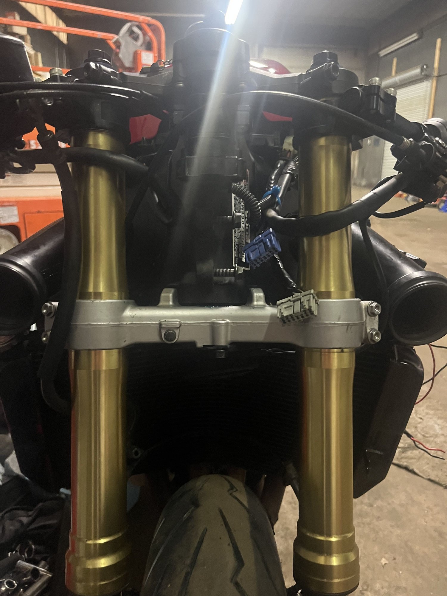

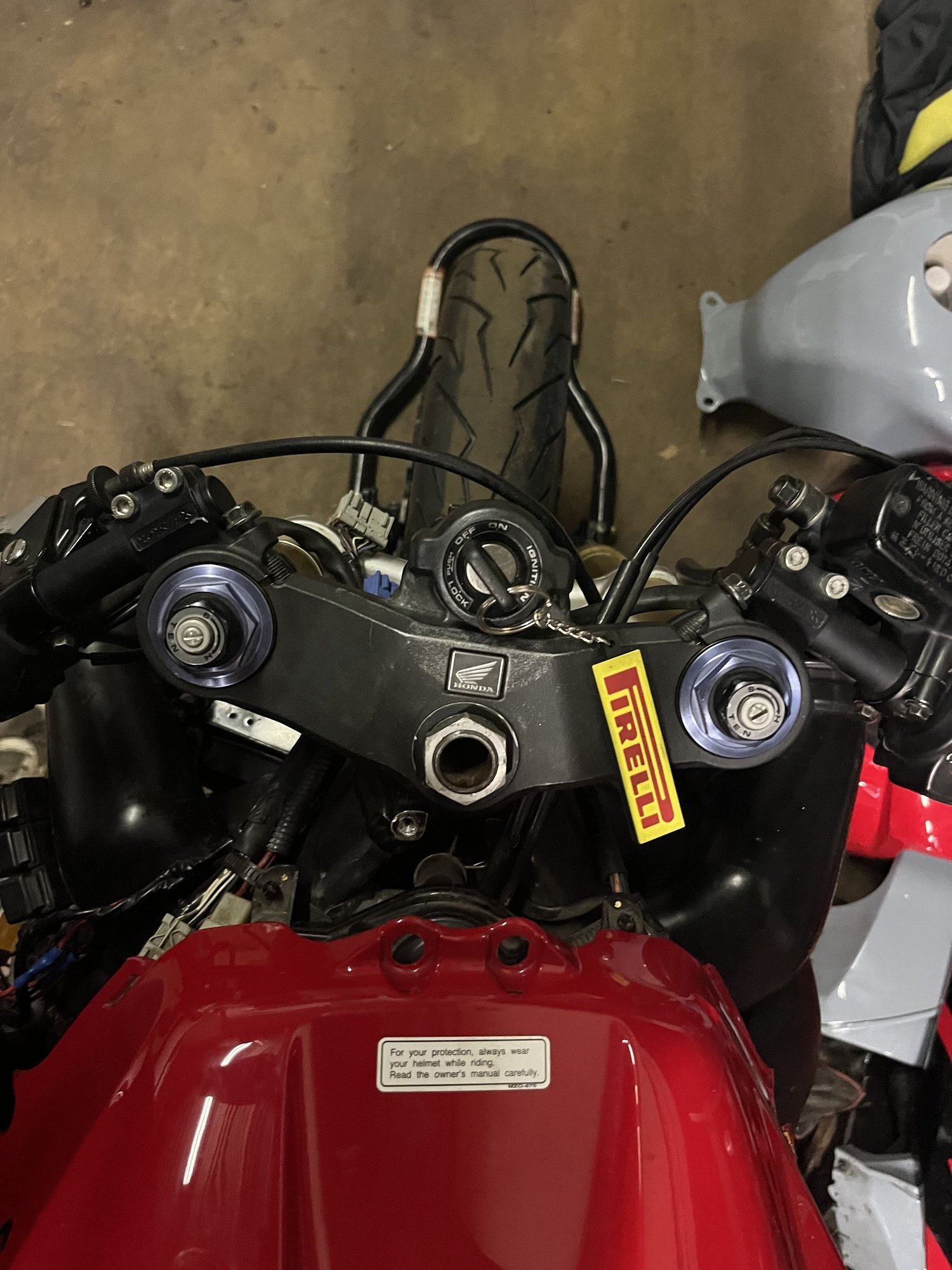

Hello so I'm working on this 2006 honda cbr 600rr for my buddy he bought it a few months ago and it's been problem after problem. I'm so lost with this problem. The wheelbase is off its roughly 53.5 inches and the front tire I feel is way too close to the exhaust causing the faring's in the front to hit tire. the stem bearings were bad, so I replaced those but still having the same problem. here are some pictures. any suggestions on why the this is happening is greatly appreciated

There's only really two possibilities, both bad. Either the forks are bent or the frame is bent around the headstock area.
Whichever, the bike's been frontended.
