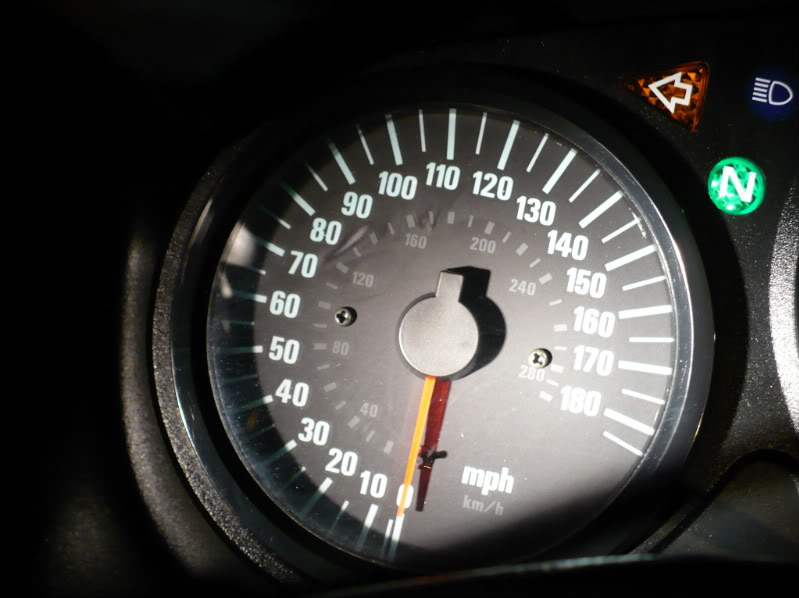

Ironically, I have a "spot" on my speedometer that appeared several yrs ago. Its had no negative effect on my speedo (other than appearance) & has remained the same for yrs. At the time, I searched for a cause but found nothing. I've always attributed the cause to an extended period of exposure to direct sunlight. I suppose another underlying cause could be possible but wasn't found. As long as it continues to work properly though, I have no intention of replacing it.
Attached is a pic of my speedo as it appears now:

Hope you're able to repair easily. Good luck on your repairs.

All the connections and fuses are good. Mine has a spot like that except its alot bigger about the size of a half dollar along with the brown burnt film on the lens. I guess I'm in the market for a new cluster then any idea where to get a good working one.
