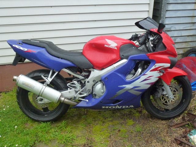

My '99
It'll be nice to have it back on the road having bought it written off ;-)
