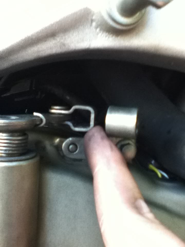

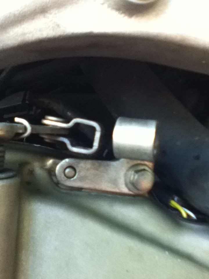

YES! I'm positive now that it is the lifter pin, as I completely removed the clutch cable and inspected it, no frays or anything like that... I thought perhaps the lifter simply got shifted but didn't know it could be broken. I've been trying to remove the right side stator cover but that damn thing seems to be one there REAL good! Once I get it off I'll be able to replace it. As stated earlier I removed all the bolts but it just won't budge! I'm pulling my hair out over this. I'm going to try with a hammer as soon as I can get my hands on it, placing a towel on the tabs and lightly tapping (or wailing) on the tabs from behind lol. Attached are some pics of the lifter pin so you guys can get an idea how close it is to the cable stay.
Does anyone know where I can order a lifter pin from???
http://i1059.photobucket.com/albums/...n/IMG_0719.jpg
http://i1059.photobucket.com/albums/...n/IMG_0718.jpg
I had a hard time getting mine off too I used a hammer and a wedge just to break the gasket seal. You need form a gasket to put it back on. Also i ordered my lifter pin from cheapcycleparts. Ronayers prob has it or a normal old honda dealership. Good luck.

Funny news guys, turns out what I was referring to as the lifter pin is actually the lifter arm... while I am quite savvy mechanically speaking, I have no idea what anything on the bike is called lol. That being the case a new lifter pin came in the mail today yayyy, now I have an extra one. Looks like the bike will be sitting for another week while I await delivery of a new lifter arm . Thanks again for all your help guys, being a member of this site has given me the confidence to really be a DIY kinda guy. Although I always have been, tackling mechanical problems on a machine this delicate would have scared me before whereas now it's no problem at all
