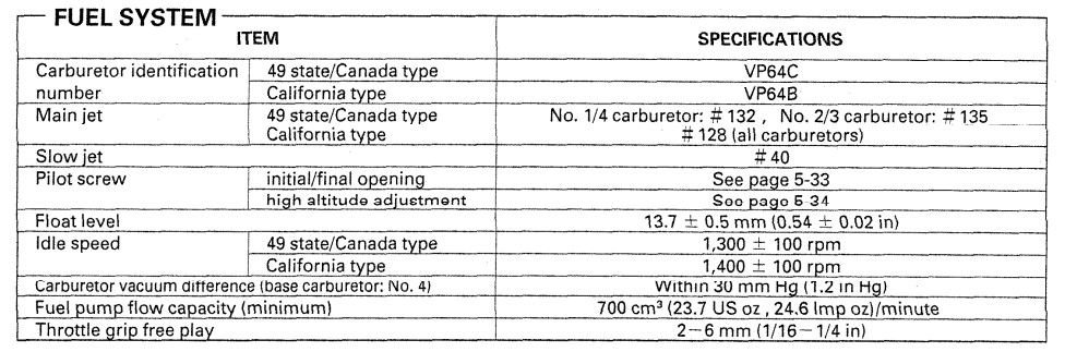

Hi, I'm stripping my carbs tomorrow, I'm looking for the spec, jet sizes etc is it listed anywhere?
Ta Ray

Here you go Ray, slow and steady is the name of the game, take lots of pics...
