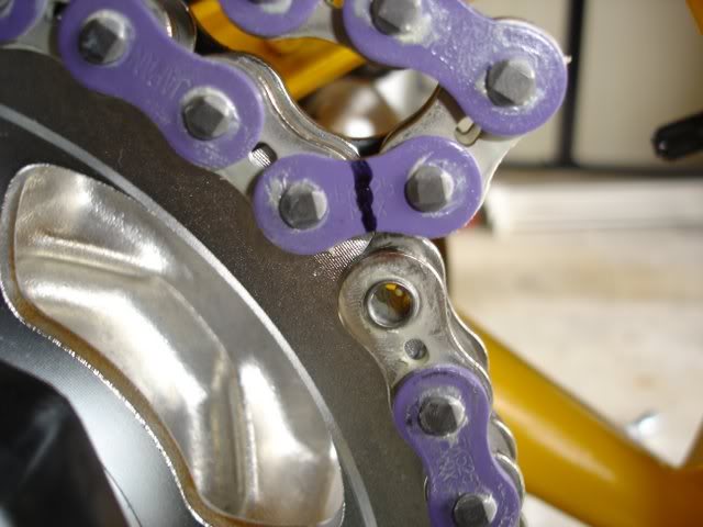

Having not changed the gearing on my bikes, I can't say for sure whether or not going down 1 tooth in the front and up 2 in the rear will make enough difference to require a longer length chain or not. If it does I can't imagine by much. Willduce is right that the standard length for the F3 is 108 links. Chains normally come in 120 link lengths, expecting you to cut the chain to the proper number of links for your particuar bike.
It's easy to do, just install the rear wheel in the correct position, wrap the chain around the front and rear sprocket and make a determination as to how long the chain should be like in the photo below. The mark on the side plate identifies the link I need to remove so that I can install a master link in it's place to join the 2 ends. You can either get a chain tool to do it yourself, or take it to a shop as someone mentioned already and have them break the chain. Either way, you're still going to need someone to install the new riveted master link. A chain tool does that too. It's worth the investment of around $75 to have your own.
