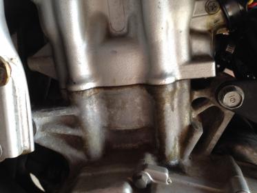

So I was riding home tonight and the bike was running perfect and then it just started losing power and then just turned off on me so then I thought maybe it ran out of gas but then I noticed the oil light was on and after getting some gas in it, it still wouldn't start and thats when I noticed that around the head gasket, there was oil coming out but there was also oil coming out by carb 1. My theory is, gasket blew on the inside and oil started to come up through the carb and mix with the gas, therefore flooding the carbs with oil and it not being able to start. I dont know anything about internals of engines so would it be cheaper to just get a new engine for a couple hundred bucks?

Old May 7, 2014 | 11:11 PM
JLAvila's Avatar
Joined: Mar 2012
Posts: 69
From: New Jersey
Check out the pics and let me know what you think. Will do a compression test tomorrow
Attached Thumbnails Think I blew my head gasket?-image3.jpg   Think I blew my head gasket?-image4.jpg
Old May 8, 2014 | 12:03 AM
Mattson's Avatar
Posts: 2,382
From: Vääksy, Finland
Not sure if this is even possible but worth checking.
Crank case breather clogged/kinked, rising pressure lifting oil/ popped crank seal.
Jus a thought cause im having this issue on my car. Hard to think of other ways for oil to get to a carb than through valve seal or crank seal. Take a whif from your radiator and/or drain coolant to a clean vessel to check for oil contamination. Either way if it really did come from inside, the bike should be smoking like a steam locomotive.
Pull the plugs for inspection so we'll know what's going on in the cylinders.

Old May 8, 2014 | 05:25 AM
jackojeff's Avatar
Joined: Mar 2010
Posts: 386
From: east cheshire
pull the motor and pull the head off new head gaskets are cheap anyway so it cant harm getting a new one but first check why it has done that
and for the rest of you remember the head has coolant oil and the bore so depending on which part of the flange on the gasket breaks depends on the symptoms
really cant understand why it would leak out the sides and into the carbs, you done an oil change recently? and check the pipe that goes from the camchaft cover to the bottom of the air box it should clear of kinks and attached to the air box
