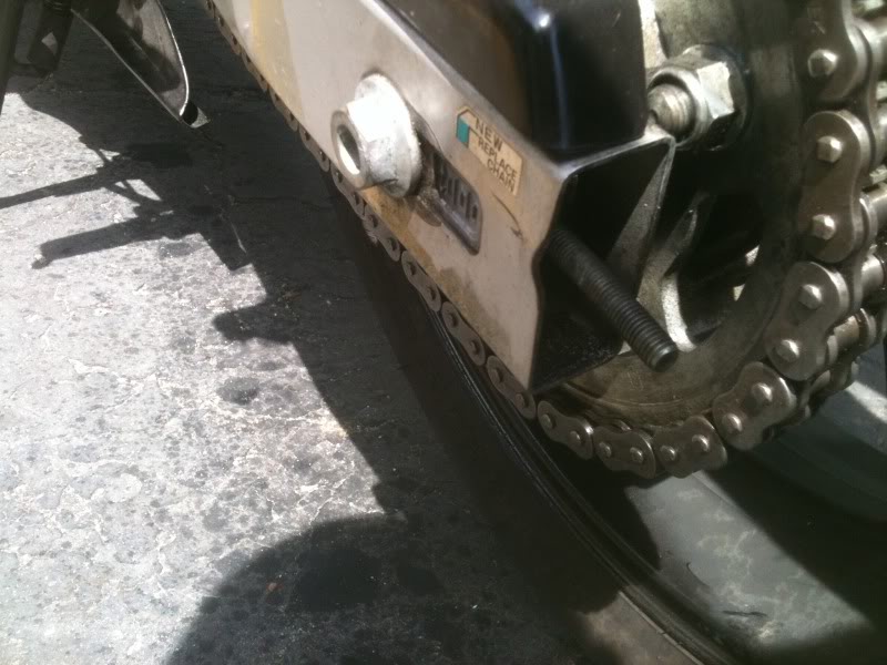

I bought a f3 and I looks like there is a piece missing that aligns the chain or something (I'm a total noob)

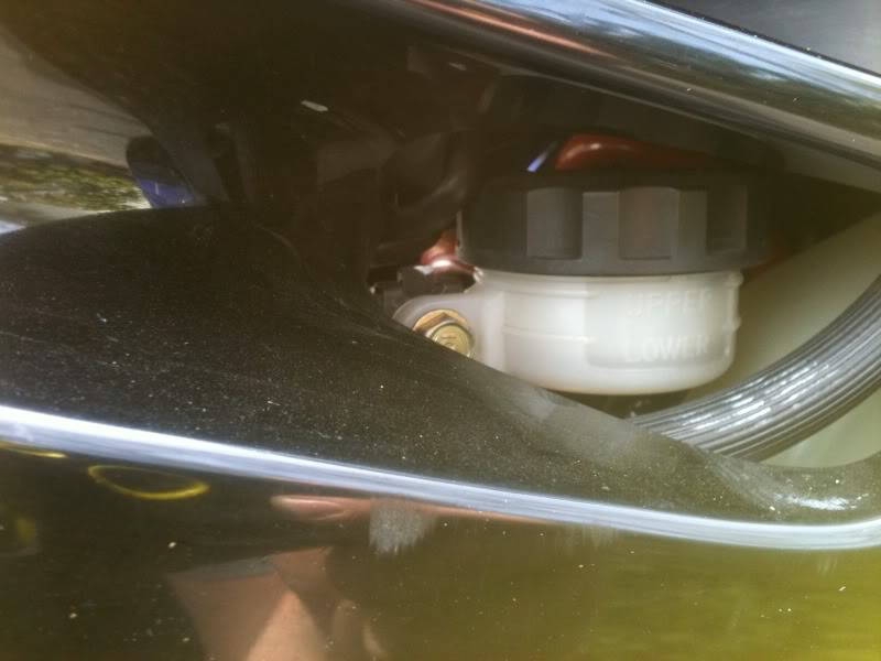

Wtf is this?, it is low and that is all I know

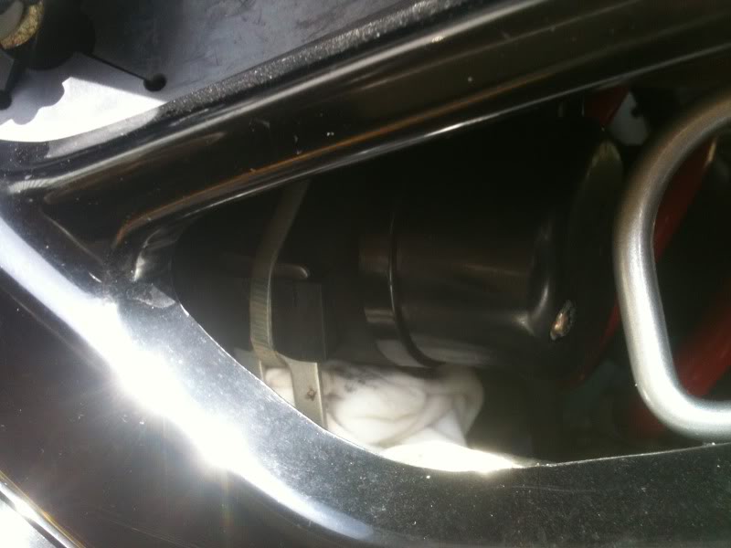

and to they make replacement rubber pieces for this fuel pump thingy, this one is all dry rotted and being held in by zip ties.

haha for real? do you have any mechincal experience at all? These are ALL SMALL EASY FIXES. (expect for the smell of fuel, the could be nothing, OR MAJOR) The missing botl and cover is your chain slack adjuster-- (im assmuiing cause ive never done it myself) but im sure you can rig up a pieice to cover and tension it no problem!
That is NOT YOUR FUEL PUMP HAHA, it is your brake fluid resovir, fill it up to the proper level (its labeled, its easy it takes 25 seconds) HOWEVER, if it is dropeing after you fill it, then you got a problem that had to be traced. DONT f*ck with your brakes! they are ALL YOU GOT....... but dont worry, it just looks low and needs to be topped up

First picture, you are missing the butt-cap to your chain adjuster, on the end of the
swing-arm. DO NOT ride the bike, until it is replaced. Don't go cheap/shoddy, the OEM
at your Honda dealer is cheap enough, just ask for #8, #23 and #24 from this fiche...

Picture two is your rear brake reservour. Look at the top of the cap for what type DOT
formula you need and top it off. Be careful with the DOT3 (The correct type for your
bike, I believe), it will eat paint.
Picture 3...See #3 on this micro-fiche...HONDA OF TULSA 1998 Honda Street Bike CBR600F3 Parts List

Your rear brake fluid being that low could be a sign of worn out pads. Be sure to take a look at them. Dont forget to look at your front pads and fluid too.

I believe I have the butt caps still from my bike (98F3), I have the entire swing arm assembly mostly. I will dig them up. If your interested, we can come to an arrangement.
