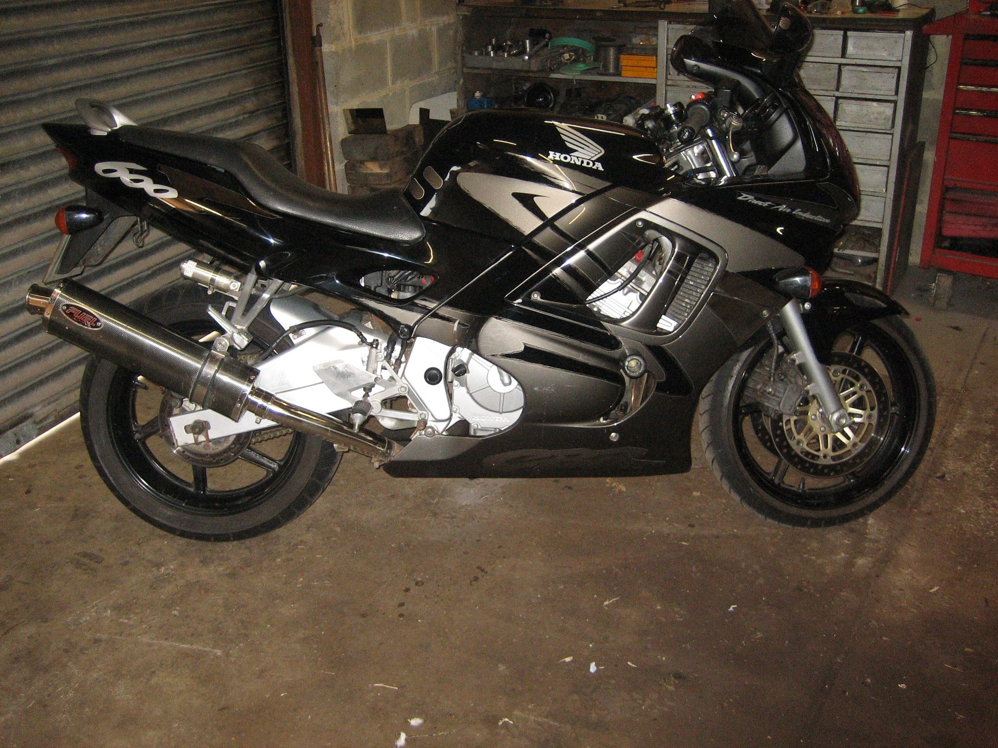

My CBR

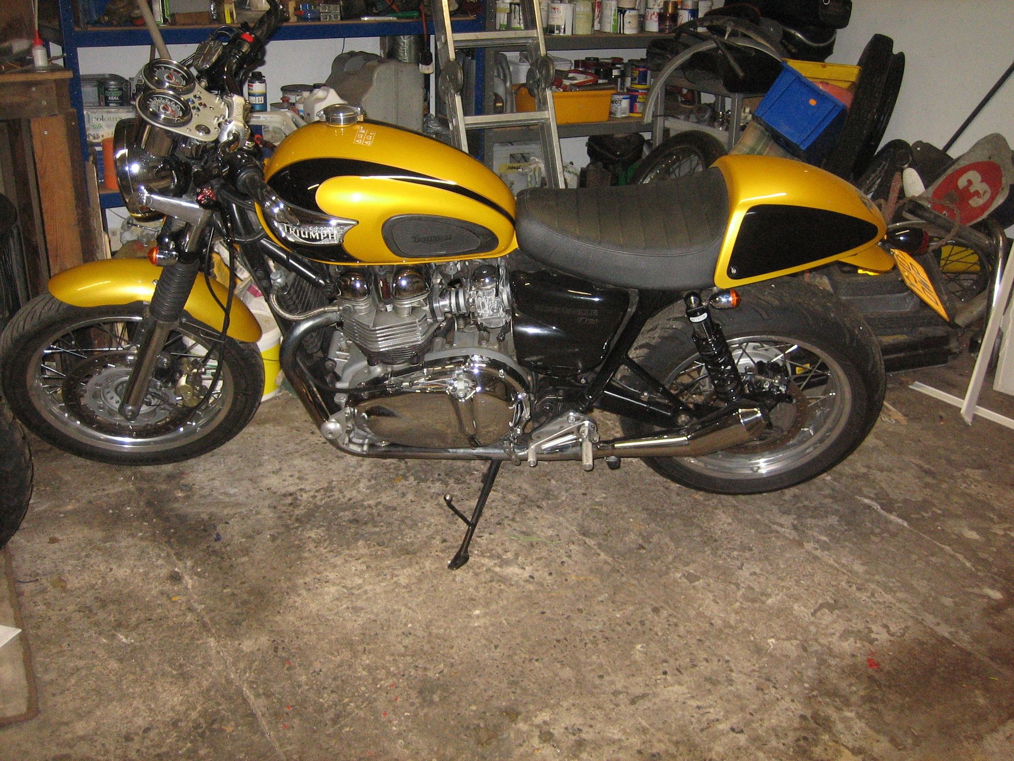

My T100

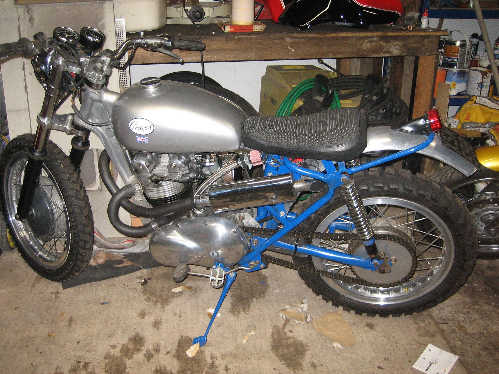

Greeves/Triumph I have just finished

That workshop floor has stories to tell!
