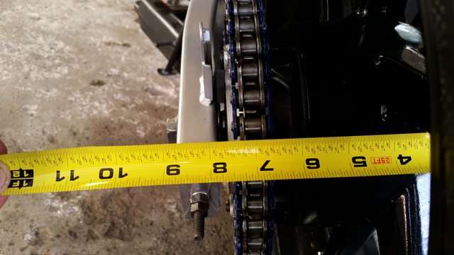

Can you measure the width of the rear wheel with the Cush drive? I am restoring a Superhawk and the 900rr rear wheel I think is a 600F3. Two different measurements but they look the same.

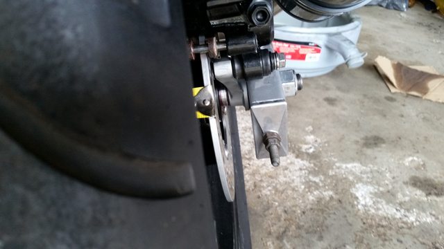

Jerry,
I measured the rear wheel to be just shy of 7 5/8" wide, not including the axle spacers.
Does the rim you have fit in the CBR900RR swingarm with excessive clearance?

I found out the guy sold me a CBR 600F3 wheel not the CBR900RR that I need. The wheel width is 1/2 inch or more narrow than it is suppose to be. Anyone looking for a CBR600F3 wheel freshly powder coated gloss black with new bearings???
Old May 2, 2017 | 05:23 PM
Jerry Anderson's Avatar
Joined: Apr 2016
Posts: 4
Superhawk rear wheel is 9" spacer to spacer. I got screwed.
