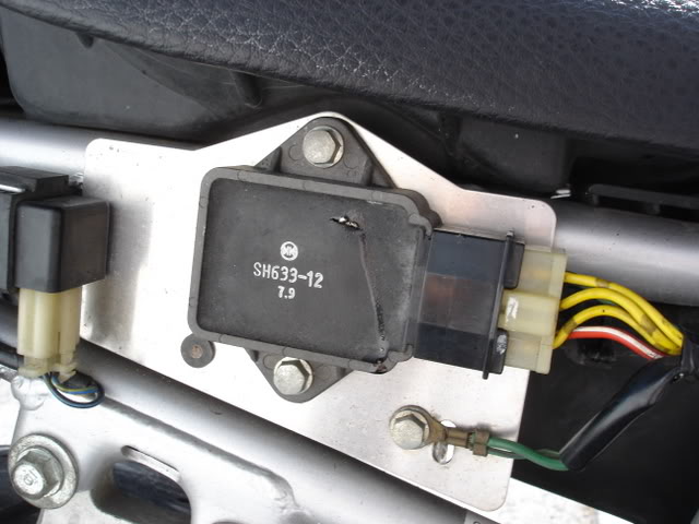

This is a factory Regulator/Rectifier. Pull the connector with the Yellow wires. if they look burnt or your's looks like this one with goo running down the face of it, it's probably bad. It's common for people to install Suzuki GSX/R regulators since they're bigger and have a really large heat sink.
