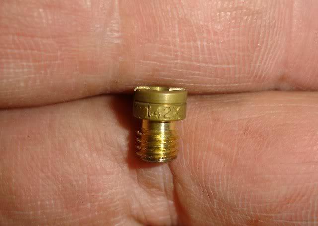

Yes, the main jets are numbered. I have seen 140 inners and 138 outers in what appears to be stock carburetors. In fact I have a set right now. The manual doesn't say anything about slightly bigger sizes, but I believe it's possible that they came with it. I just rebuilt a set that had these sizes in it and I did put 138's and 135's back in it just because that's what the manual says. I would think that if during production, if a bike was running a little leaner than they wanted, they would fit carbs with slightly richer settings. Usually when aftermarket jet kits are put in, the needles are replaced as well, like the ones that Battousi is seeing in his. The ones I have still have the original non-adjustable ones. The main jets look original, but you really can't be sure.
This is a "Factory Pro" jet that is in my wifes 97 F3. That's the reason for my other set of carbs. I'm putting an original headder back on with just a slip-on and I needed to put the carbs back to original.

Yes, I believe it's been jetted. Now, it's my understanding that when you install a jet kit that you not only replace the main jets, but replace the needles as well, and drill out the hole in the bottom of the slide. I've never put a jet kit in, so I don't know if you do different things to it depending on how large of a change you're making to the air-flow characteristics of the bike, like full exhaust, K&N filter, or modified airbox.

Someone has definitely been inside his carbs. As you corrected me once, stock needles don't have e-clip settings.
If the needle is tapered, not going to straight point, then he prolly has a Dynojet Stage 1 kit in there. Those jet sizes sound like the ones I used for mine when I jetted my bike. K&N Filter and an unknown slip on exhaust
