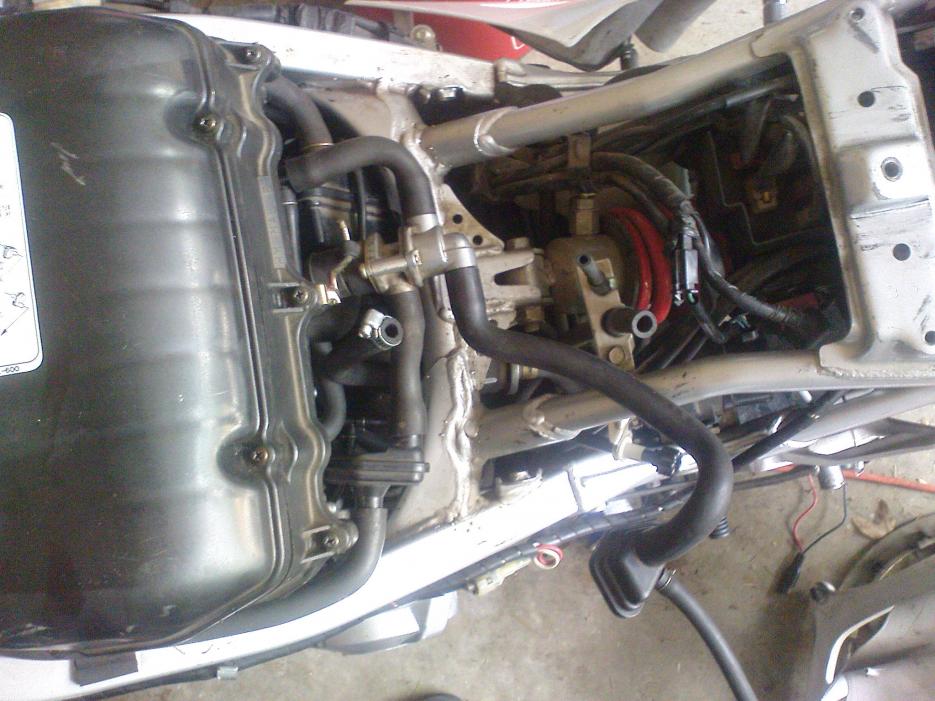

so the deal is that one day i started it and i think gas was gushing out of this hose sticking out to the right side of this picture (picture is in the attachements)..
bike would turn on but when i pull the gas..
it would cut off, i pullled out the carbs and cleaned them out since i heard it was good to clean them.. i put everything back together and now it wont start this is whats happening
http://www.youtube.com/watch?v=2kcE2Z0NjaE
any ideas?

My bike did that once, changed my plugs because they were old and fouled and vroom bike started right up. Also I had gas come out of that side too once. I think its from using the choke it does that.

i jus diagnoisss mine and it was the fuel pump . so check that out

could probably be the fuel pump cuz it started when i put gas straight into the carbs meanning spark plugs are good for now ill check it out.. thanks guys!

replace your plugs, or test em

ok well i got it to run for a while with the choke on but after a min or two.. when i try to take the choike off it would die.. and wont turn back on unless the choke is on..so i left it.. the next day i tried starting it again, wont go anymore.. starters good but it wont go not even with the choke on

Idle could be low.

ok wait one question.. turn it
clockwise = idle higher
counter-clockwise = idle lower?
is that correct?

^^yup , thats right..adjust them when bike is warm

haha you were right! thanks for everything hope yours gets working soon too!
