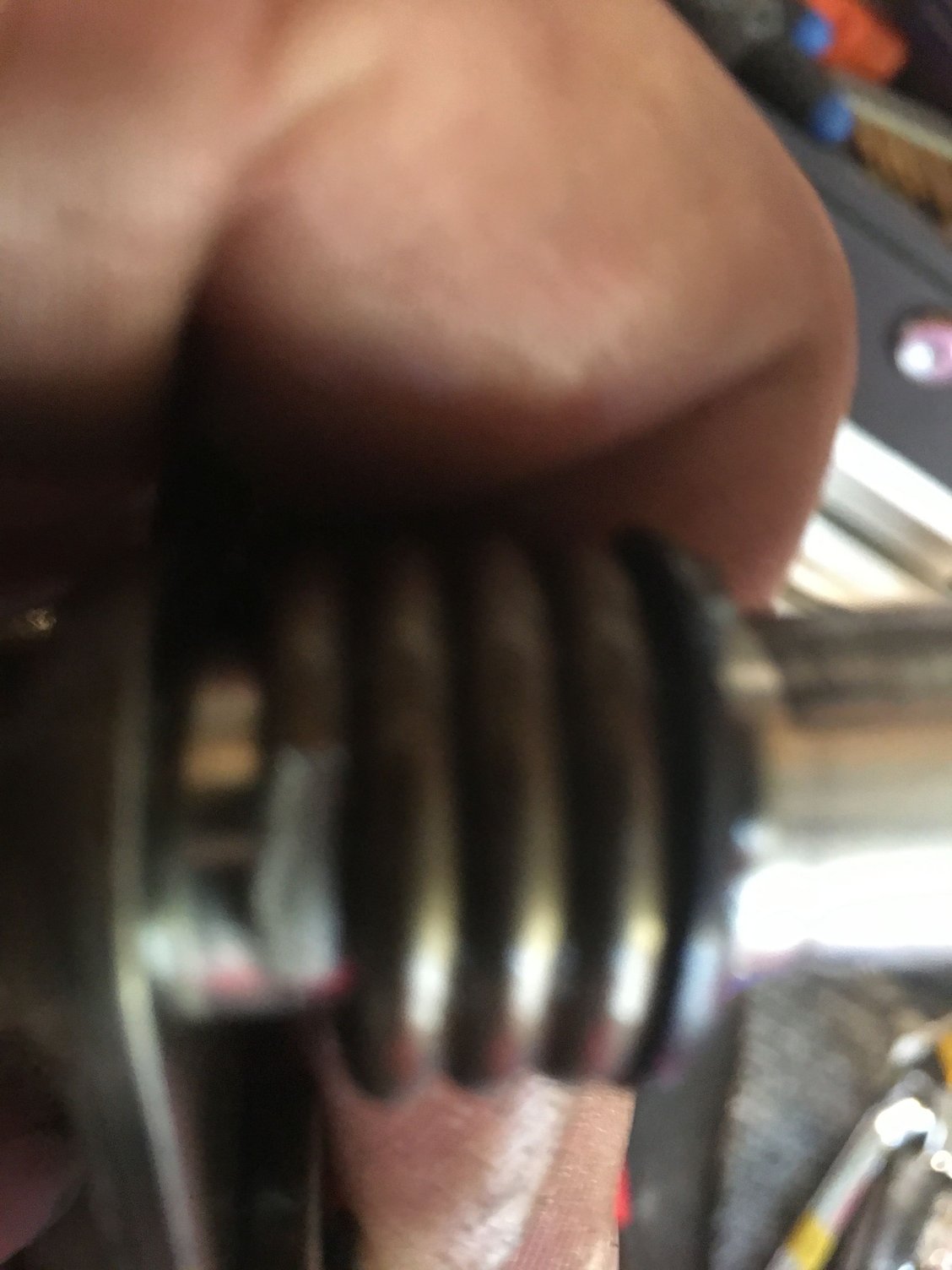

Cool Found broken piece
How lucky that I found this small piece in the bottom of my sump! Hopefully it’s done no damage?
Old Aug 23, 2021 | 08:40 AM
Posts: 2,568
That's not good, did you find the rest of it?

The rest was on the gear rod luckily , not a very good picture sorry, I’ve taken the sump off and checked everything! I might be very lucky, both of the broken pieces fit together perfectly!
Old Aug 23, 2021 | 10:29 PM
That's great, glad it is working out. I'm sure it will be nice to know that you really do know how to shift too... LOL
