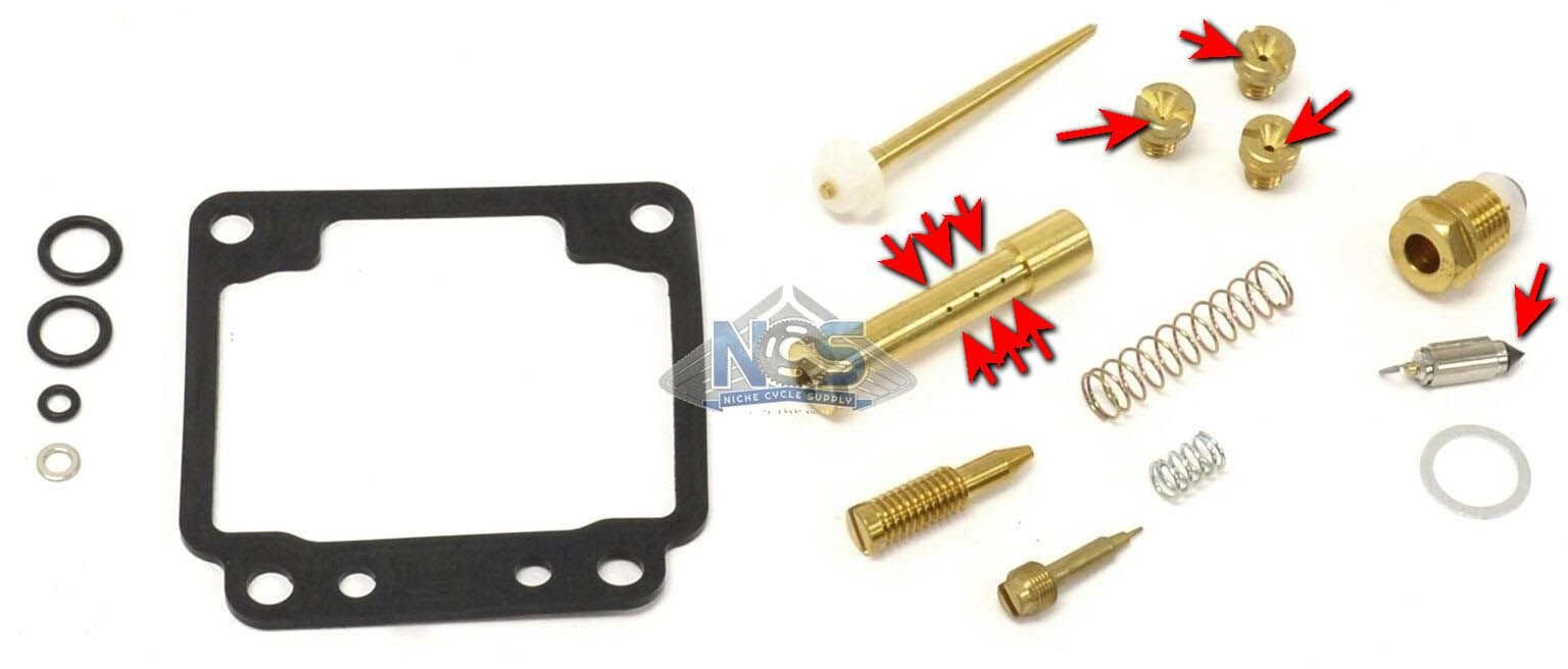

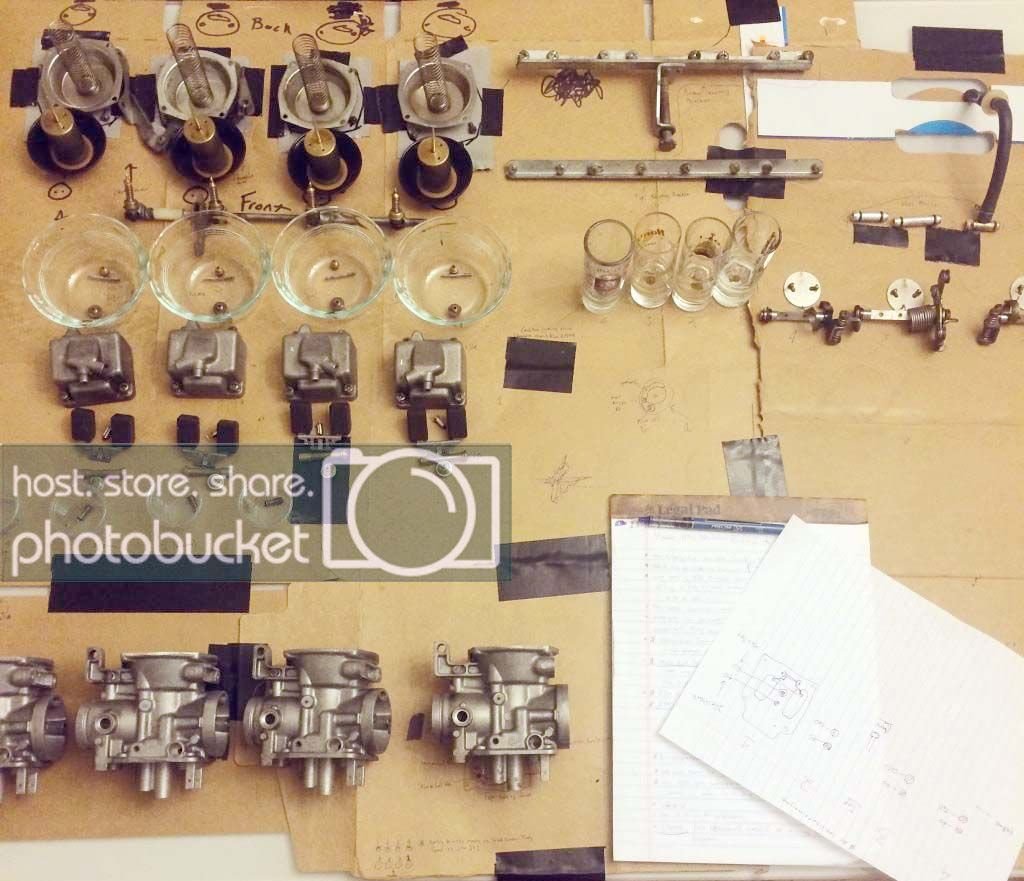

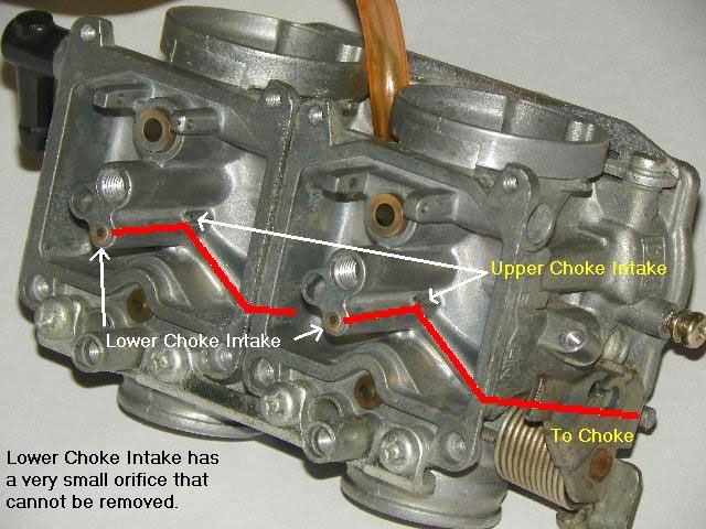

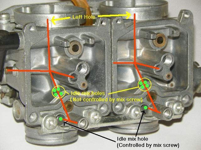

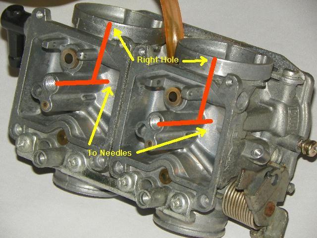

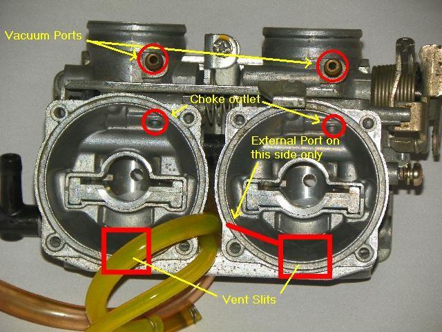

Carbs and petcock needs complete disassembly for overhaul and restoration. Sitting causes petrol to dry up into plastic and clogs all sorts of tiny passages between jets and bleed holes in carb-venturi. Also messes up float-valves and they don’t seal. That’s problem here where float-bowl is filling up too high and petrol is backing up into air-passages inside carb and venturi. Leading to too rich mixtures. Liquid petrol dripping down into cylinders can also accumulate and hydro-lock engine.
Need to completely disassemble carb down to every last nut, bolt and individual component for scrubbing with PEA-based fuel-system cleaner. Spray “carb cleaner” no longer works due to removal of chlorinated compounds. Poke out all bleed holes in emulsion tubes and carb-venturi. Scrub out all secret hidden passages in carb body. It’s places you can’t see that hides worst clogs.
Then ultrasonic soak everything. Micro soda-blast everything for final cleaning. Replace all rubbers when re-assembling: petcock diaphragm, float valves, fuel-rail O-rings, pilot-screw O-rings, float bowl seals and even slide diaphragms if needed. Set float heights with wet-test confirmation. Balance carbs when installed. If you skip any of these steps, carbs won’t be fully factory-fresh clean and bike won’t run right. Thus, requiring yet another carb pull! Typically requires pulling carbs 5-6x for ever deeper cleaning before they’re back to factory-fresh OEM clean. One guy had to pull then 10x for deeper cleaning before it ran right!
Easiest and fastest way fix this is to send carbs+petcock to pros for expert restoration services. They have experience with repairing thousands of carbs with decades of experience. Reasonable fees and quick turnaround.
