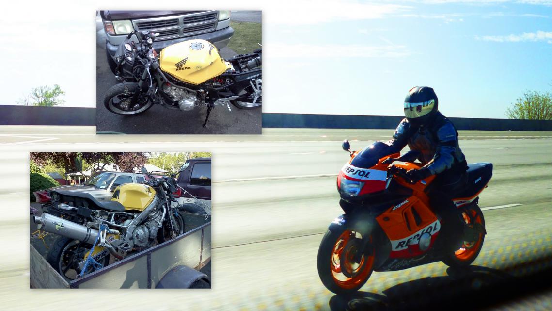

I just had a thought. The bike had been sitting for quite a while before i got my hands on it and it hadn't stored properly. Could it be possible that my radiator is gummed up on the inside so that when run the bike harder it cant handle the extra flow of coolant so it just overflows? If so, is there some process/chemicals i can use to clean it out and allow it to flow better? Just for the heck of it here is a pic.
