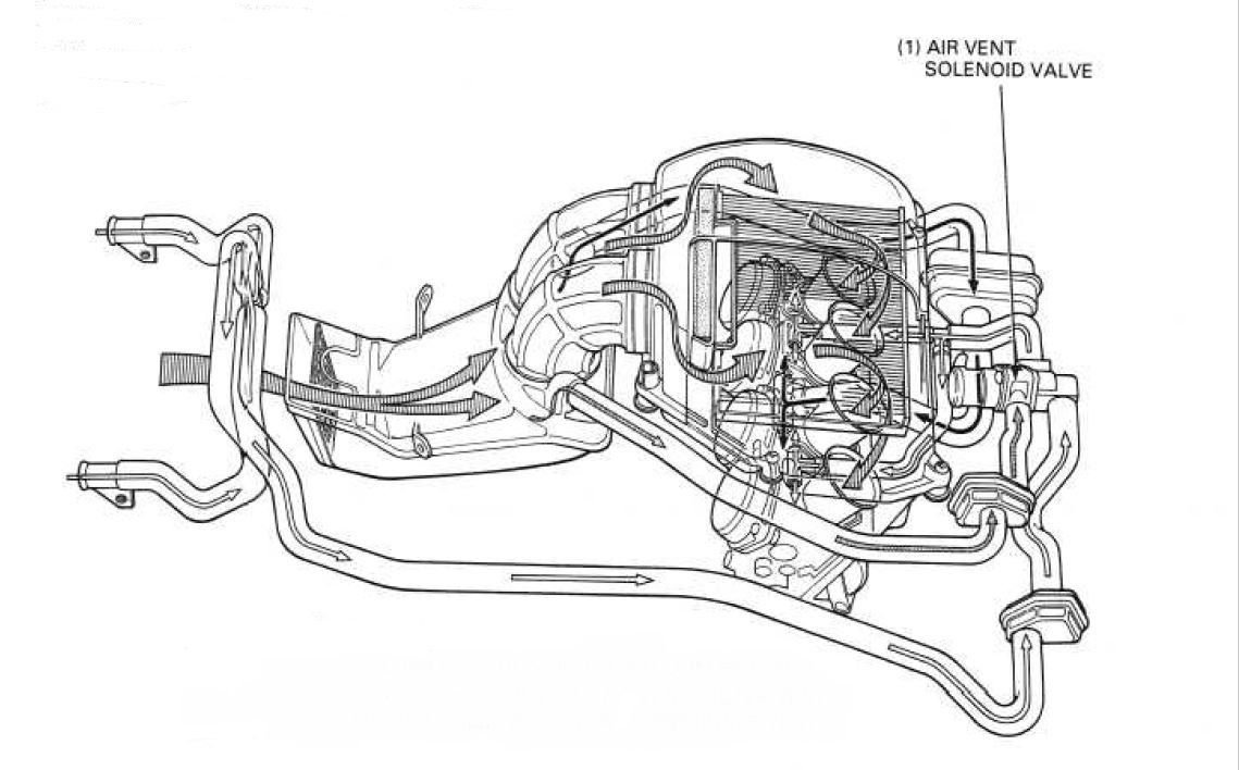

Well I’m not sure about rpm I know if I try to just cruise at 55 60 it does it or wether I open it up it does it. I’ve read a forum on dai an looking into that at the moment. I replaced my fairing an when I did I could remember how the bracket when to hold the tubes in place so I just set them in the spot they went. Maybe they aren’t getting the full air flow. I also repainted my tank an looking into my vacuum on my tank

The DAI solenoid kicks in at about 20mph, (if working correctly) make sure you have the Air solenoid Electrically connected, This is how the pipes should be connected
