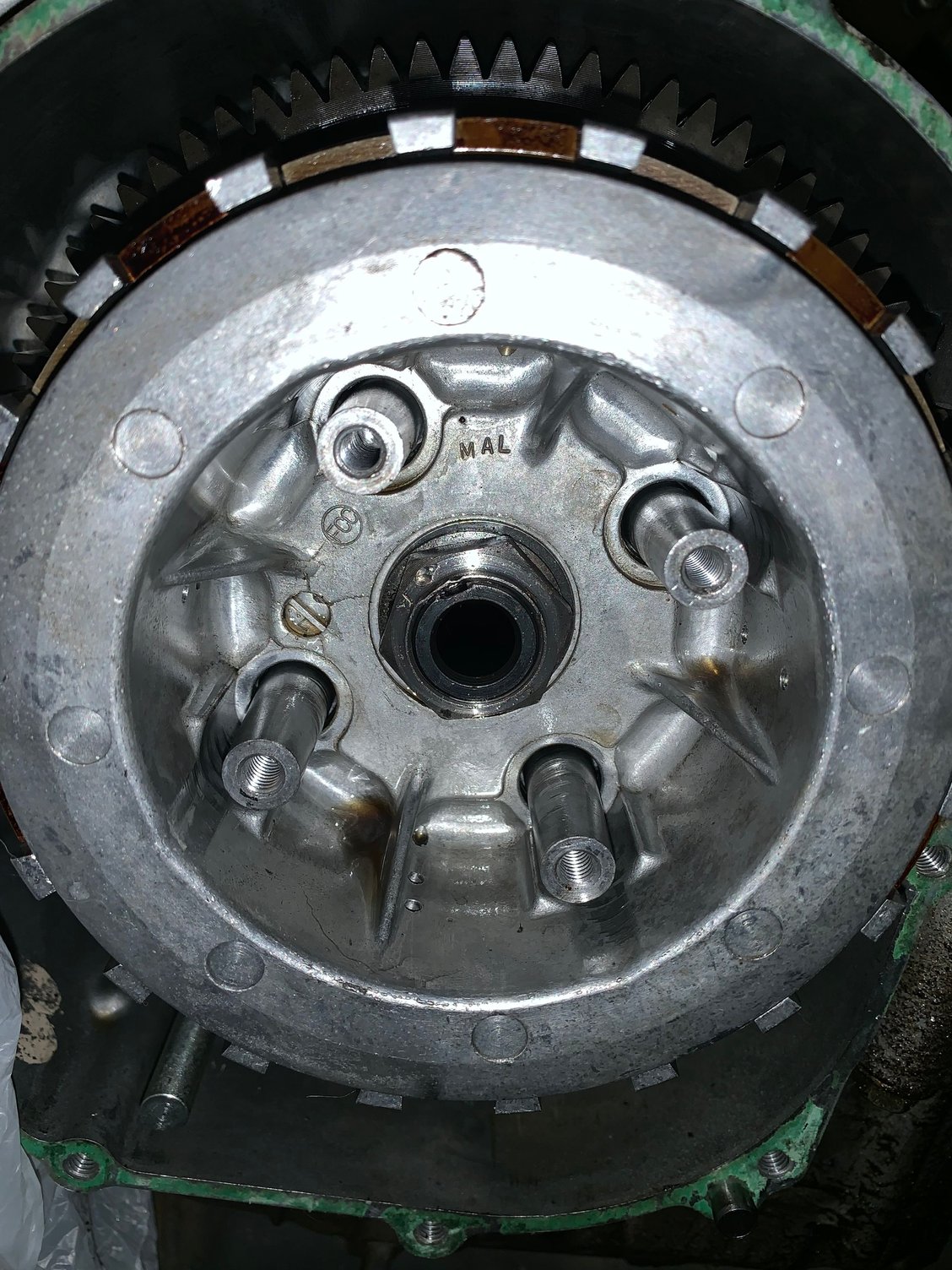

I’m replacing the friction plates on my F3, and I have all the right size sockets except for the center lug. Does anyone know what size socket ima need? Pic provided

Hi M20 so should be 30mm Socket

It’s the big one in the center I found it’s actually a 27mm. I just need to find out how to get the thing off without that special clutch tool. I heard u don’t need to use the tool with an impact but idk how I’d go about torquing it when I put it back on.

Without the tool it's quite hard to do, dont use a screwdriver across the post's or you could break one off, you could try jamming the gears at the back with a cloth to stop them turning, and are you sure about the nut, take a look here
