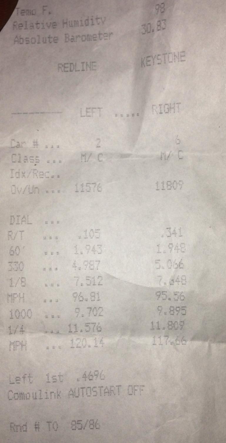

I have pics of my track slips. I gotta get them off my phone, I lost both races to my buddies Ninja 1100. but not by much.... on the first he got me running 11.88 and on 2nd he had 11.5 something. his best run was 11.40 flat for the night. so i'm feeling good about my times.

so I'm a little dyslexic, I'm bike 6 on the right.
Attached Thumbnails 1/4 mile times and Help Needed!!-track-slip-july-26-2013.jpg
