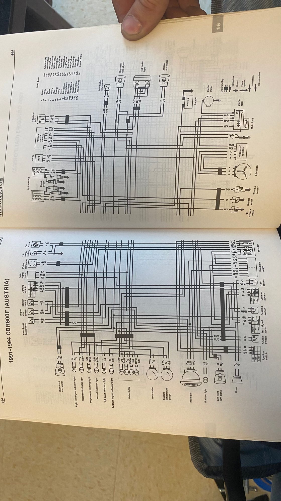

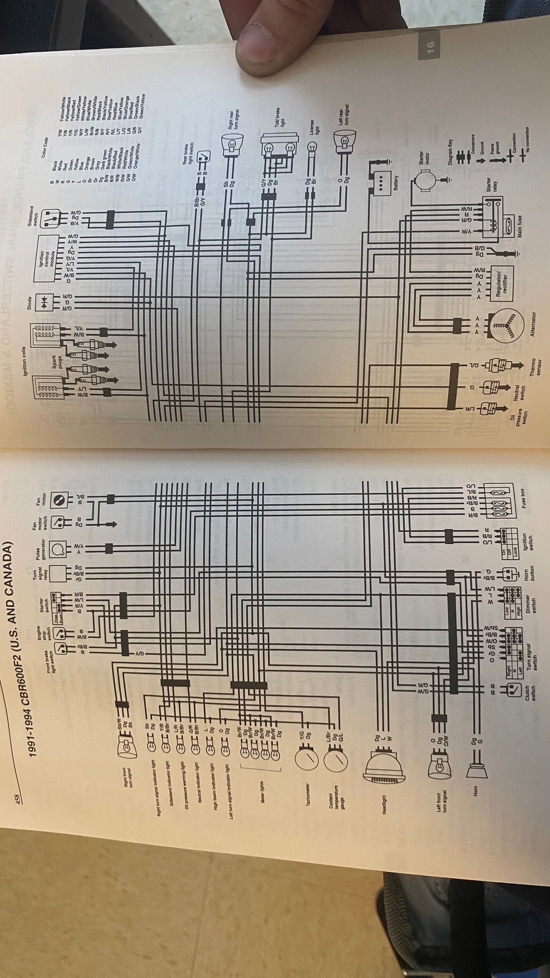

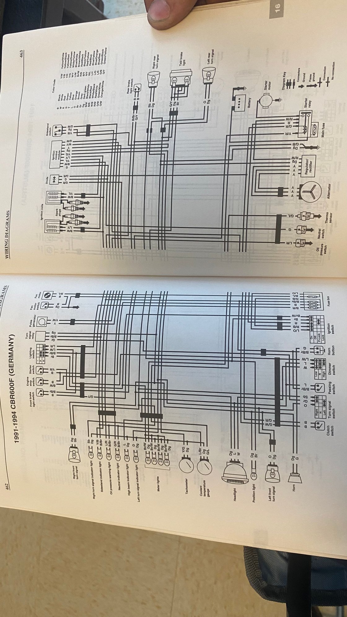

Old Feb 11, 2025 | 08:12 AM
patrick71669's Avatar
Joined: Mar 2024
Posts: 3
Default here are the wiring diagrams for the cbr600 F2
