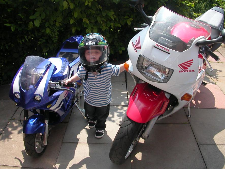

Default the bike
here is the bike in question, ready to go again. in the middle of modding it. wanted to bring it up to date. Gonna change the front end next for a 05 rr headlight and modd the upper fairing

The bike looks great.

Default 600RR rear on a CBR600F2
cheers mate, yep quite pleased the way it looks so far. a lot of head scratching before making cuts to the rear frame. i have lots of ideas and the parts to put on. my son has the YZF R6 09 nice bike and keeps saying to me " get a new bike" why ? mine aint broke still makes me buzz when i,m on it. i like the thought of putting my mark on it and it being different, watch this space lol. ride safe
