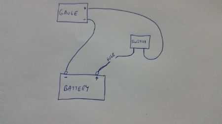

How did you wire the battery voltage meter up? To any 12v ignition wire, or straight to battery

I did the positive wire from the gauge to a on/off switch to a inline fuse to the battery.
The negative side of the gauge to the negative of the battery.
Here is a quick drawing.
Its like having my voltmeter hooked up all the time but with the switch i can turn it on and off when i want to.

The switch is just to turn it on and off yea? That's pretty simple, thanks
