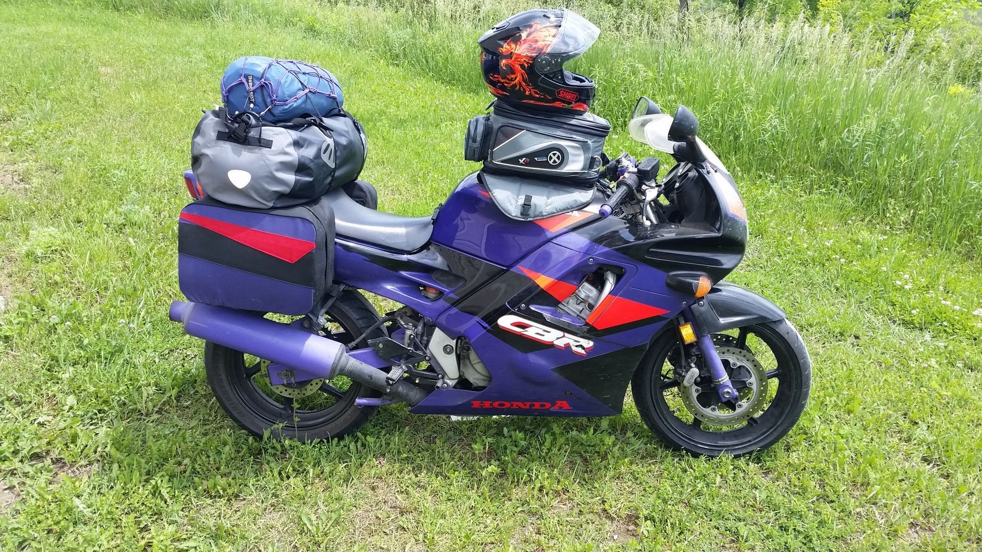

Now I am going to go on a long ride in May of 22. I am going to ride to Kentucky to graduate from my Masters program. The question I have for you know is how and where and what type of saddle bags do you recommend for my f2? thank you kindly.
Old Sep 9, 2021 | 11:56 AM
Phil314's Avatar
Joined: Sep 2008
Posts: 674
Likes: 53
From: 45.2521, -93.5612
Congrats on your Masters. That's awesome.
There are no specific F2 saddle bags.
But there are many universal ones that will work.
Just depends on how big you want them and how often you use them and how much you want to spend.
Long time ago, I bought some RKA 47 liter bags. They are big and well made, but also expensive.
They are great and for me, they were worth it. The square shape makes them easy to pack.
I've taken many 2+ week camping trips with mine. They will hold all my clothes and some tools.
I also have a 60 liter dry bag for the tent/sleeping bag/sleeping pad + tankbag for electronics/wallet/etc.
It also helps to pack everything in ziplock/trash bags inside the luggage, since no luggage is ever fully waterproof.
