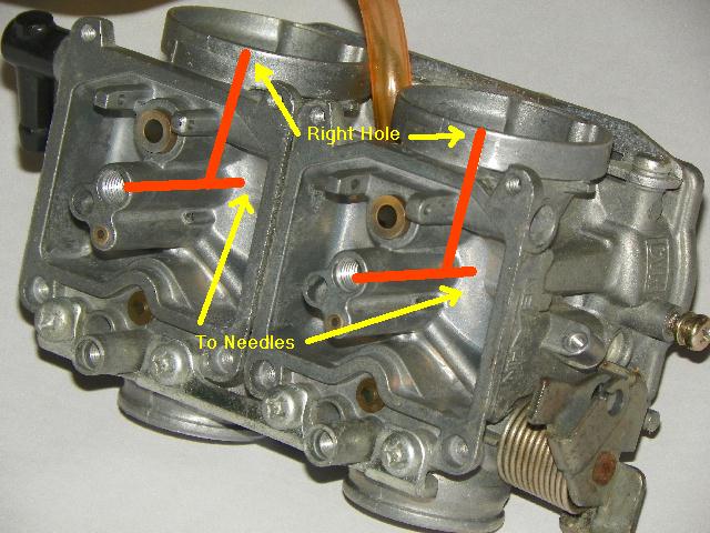

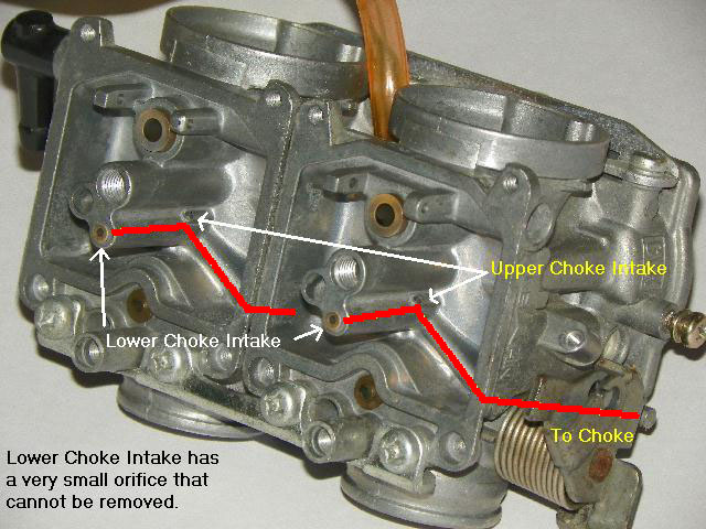

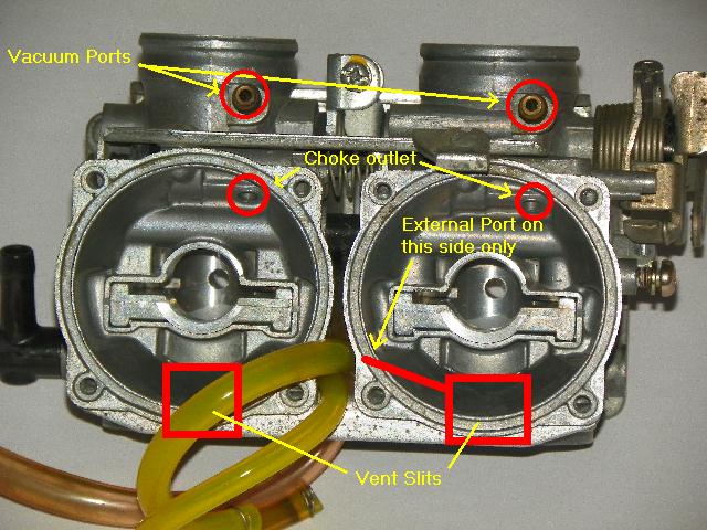

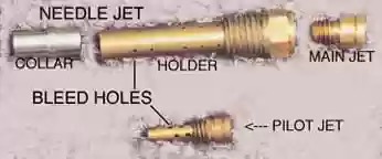

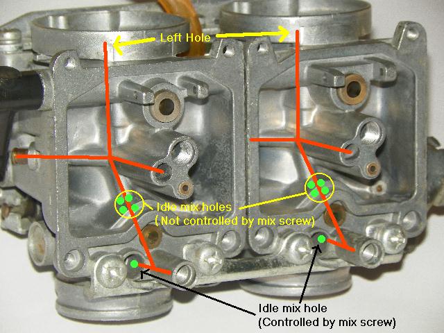

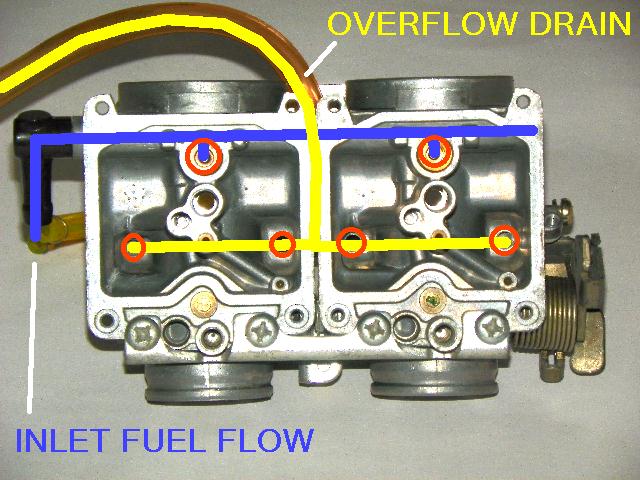

When was last time valve-clearances checked and adjusted?
If it idles OK, but dies when open throttle, carbs are not factory-fresh clean. Many expert mechanics have had to pull carbs 4-5x for ever deeper cleaning before they were restored back to factory-fresh clean OEM condition. You actually need carb restoration, cleaning is not enough.
1. completely disassemble carbs to every last nut, bolt and individual component. If it can be further taken apart, do it. Take lots of photos and videos so you can put it back together properly. Compare to factory service-manual, just in case previous owners modified anything. Needle jets upside down is common mistake.
2. Completely disassemble emulsion-tube and pilot jet.
3. clean out all secret hidden passages in carb-body with PEA-based fuel-system cleaner and
<b>scrub brushes</b> scrub brushes
. Note: spray “carb-cleaners” no longer work due to removal of chlorinated compounds. Thanks a lot crunchy-granola, tree-hugging, bark-eating smelly hippies! For different model, but yours will be similar:
4. Poke out all lateral bleed holes with soft copper wire. Dried petrol turns to plastic and cannot be dissolved again. Must be mechanically scrubbed away. Also poke out all bleed-holes in carb-venturi towards float-bowl.
5. Ultrasonic soak everything for days. Micro soda-blast everything before reassembly.
6. Replace all rubbers: float-valves, pilot-screw O-rings, fuel-rail O-rings, float-bowl seals, slide-diaphragms if needed.
7. Set float-levels to stock. Verify with external wet-test when back on bike.
8. Do rough bench-sync. Then fine-tune with manometers
If you skipped any if these steps, that’s why bike isn’t running right. When carbs are restored back to factory-fresh clean, it’ll run like brand-new off showroom floor. That kind of restoration requires lots of specialised equipment and decades of experience on hundreds of sets of carbs and even destroying some in process of learning. Best to send to pros for expert restoration, reasonable fees and quick turnaround.
