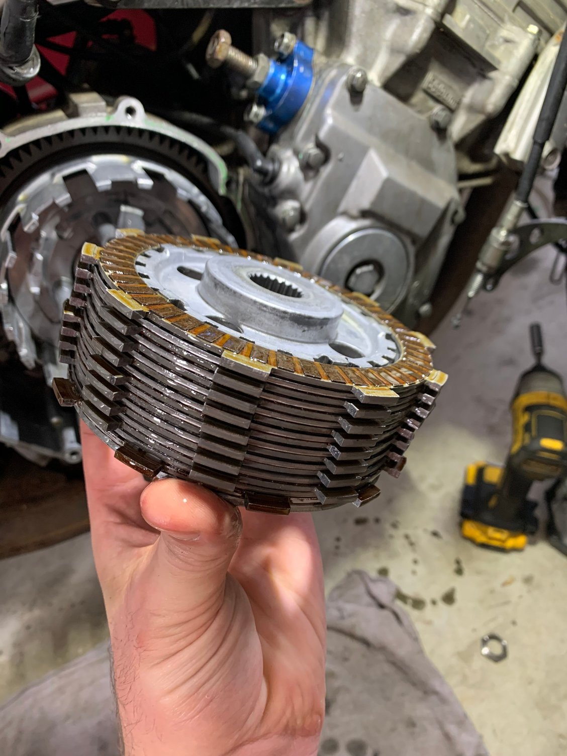

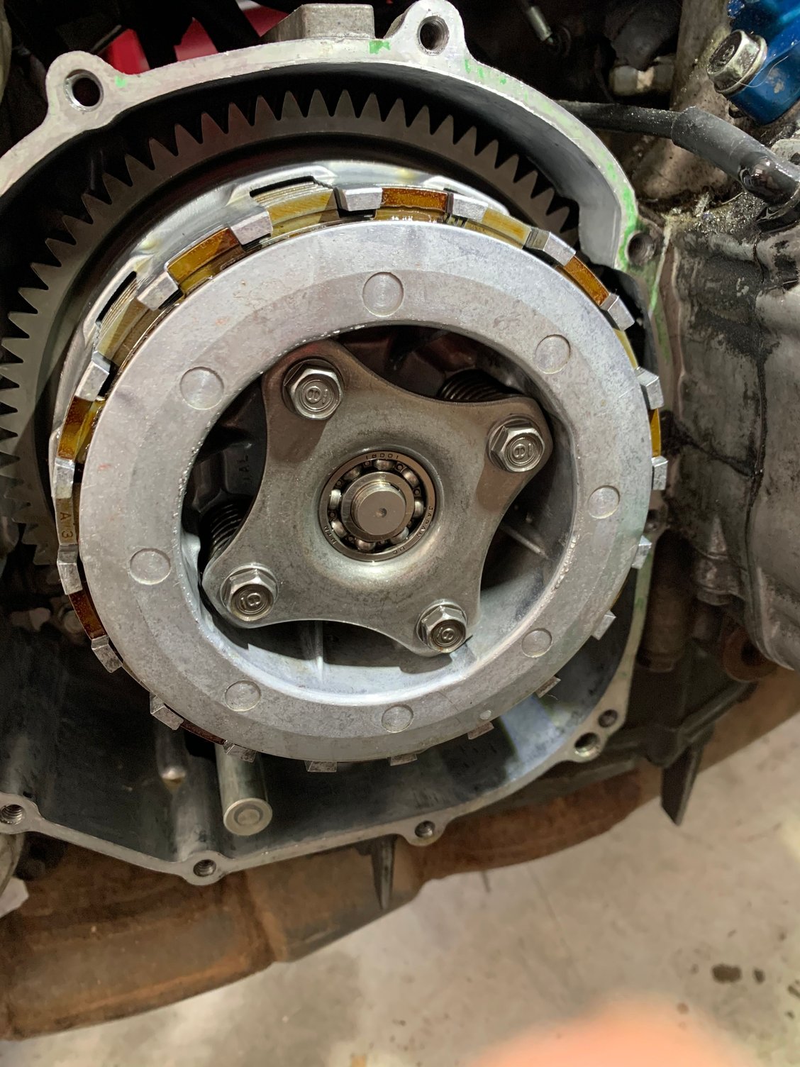

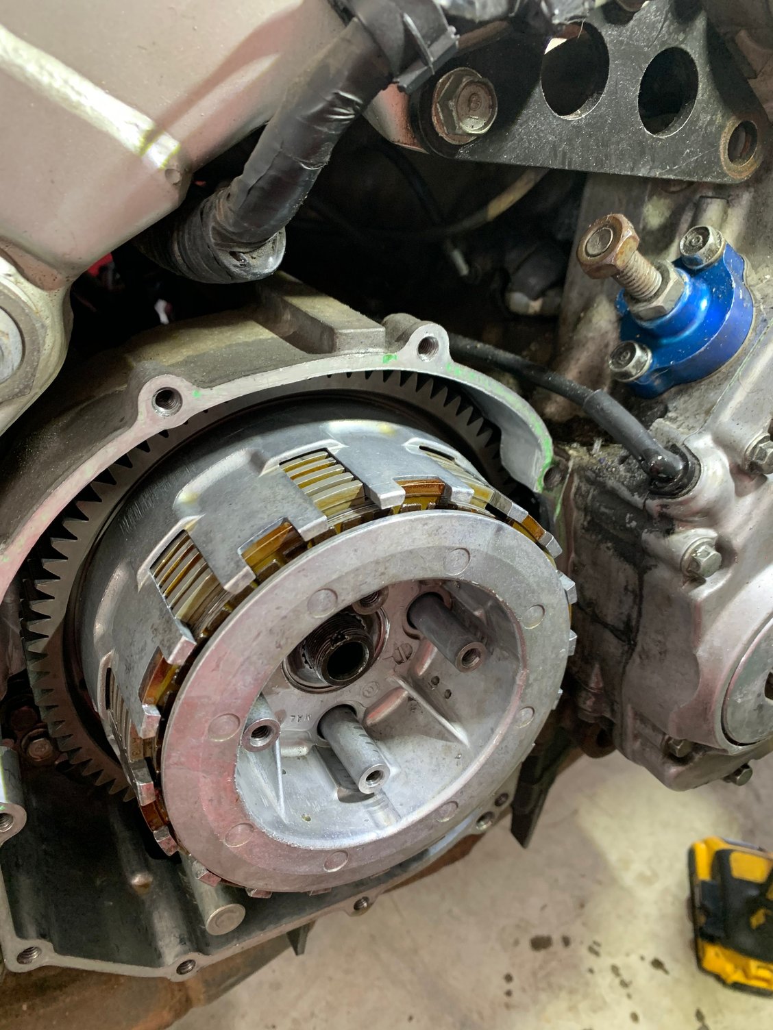

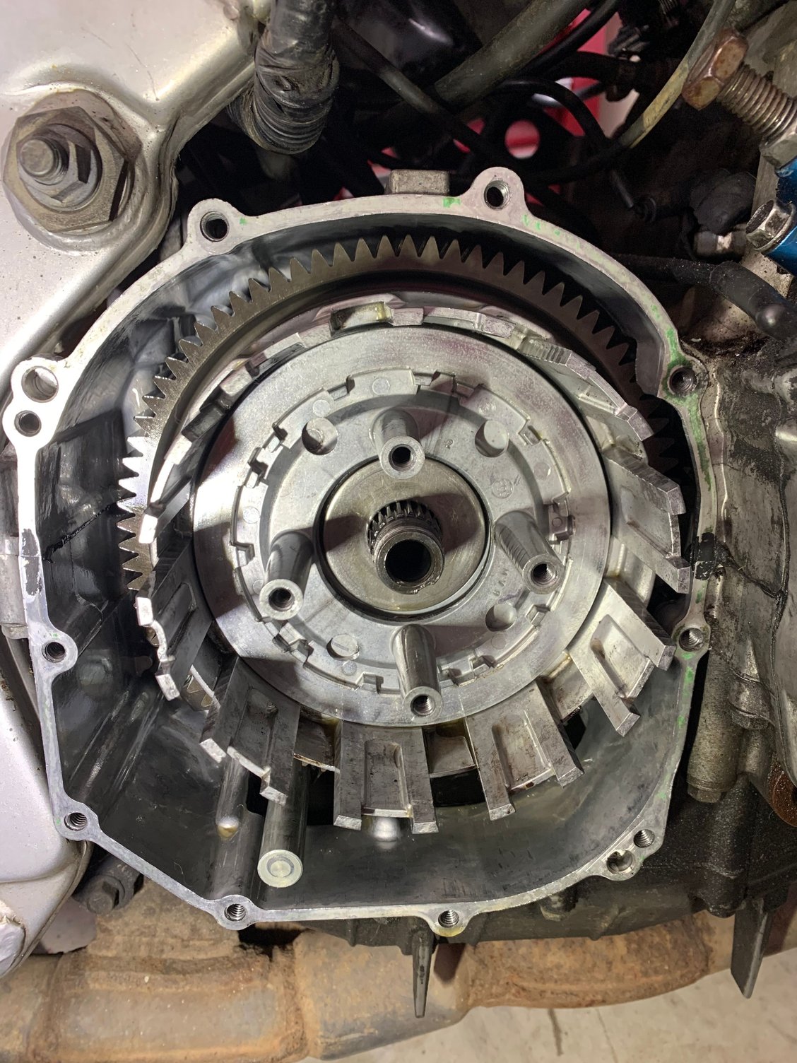

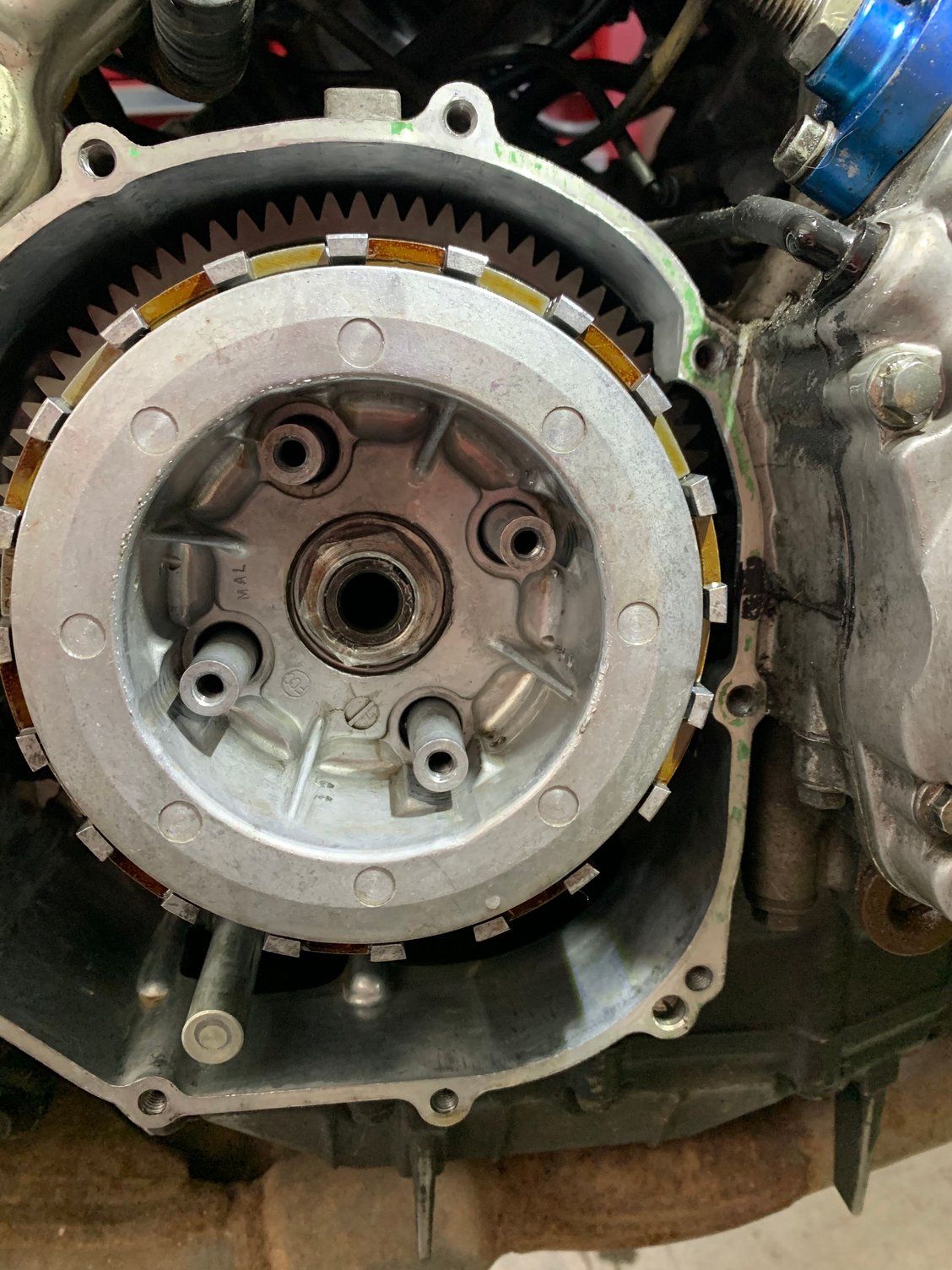

Day late posting an update, but I finally got back to it today. Took the clutch back out, turns out I did have the judder spring in wrong. Fixed that, made sure the friction plates were all in spec, and reinstalled. Now for some reason, the lever is completely dead. Like loose and floppy. Adjusted the cable until it felt like it should be pressing on the clutch, and it’s as hard as a rock and I can’t squeeze the lever at all. I’m at a complete loss here. Took a bunch of pictures during the reinstall though, so if you see anything please point it out, no matter how obvious lol

ok, 2 things to check.
In the clutch cover is a clutch lifter pin.
They can fall out during reassembly.
If you look straight down from the top where the clutch cable attaches to the clutch arm.
The arm should be at about 8 oclock with the clutch lever all the way out.
about 10 oclock with the clutch lever pulled in. 12 oclock points toward the front of the bike.
Or take the cover off and make sure the pin is working properly.
2nd, then look at the clutch springs and see if they look like they are fully compressed.
If they are you won't be able to squeeze the clutch.
If so maybe remove the 4 bolts from the lifter plate and the remove it and the springs.
Once the pressure is off the clutch, grab a pair of the bolt hole towers of the rear pressure plate.
It should have some wiggle to it and rotate slightly (within the holes of the clutch center plate).
It's the piece that moves to engage/disengage the clutch. Make sure it's not stuck for some reason.
Old May 17, 2020 | 12:23 PM
Nathan71592's Avatar
Joined: Apr 2020
Posts: 8
I got the clutch sorted out about 20 minutes ago. Ended up being that I didn’t have the clutch center and the the piece with the 4 posts on it for the springs lined up correctly. I had no idea that it could only go through the holes on the clutch center one way for it to slot in properly. Clutch has some chatter at idle now, but otherwise functions exactly how I would expect. Rode it around the parking lot a few times shifting between 1st and 2nd to verify.
