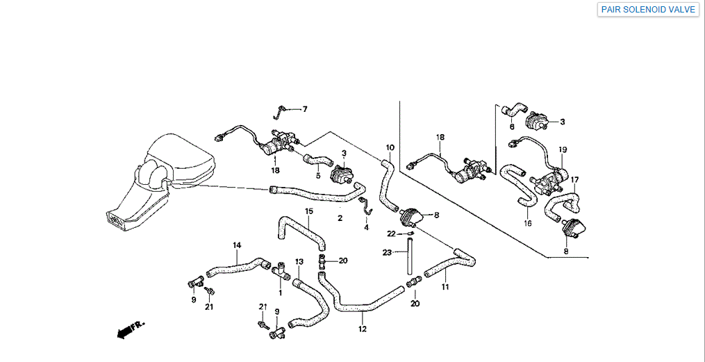

Hi Gunk maybe a removal of the air solenoid could give you an idea if it still runs the same with it missing
Sorry to hijack this thread but I’ve been thinking about your suggestion Bill and how best to do it.
Am I right that if I just connect Tube 5 to hose 10 and leave everything in situ, I’ll bypass the solenoid?
If this is the case and it runs fine I could then just rip it all out

Hi Gunk, yes basically, just follow the front pipes from the nose intakes, disconnect them off the solenoid and connect the Hose 10 and 5 intakes together , you can leave the pipes in place, in case you want to set it up with the solenoid later unconnect the solenoid as it wont be needed, all air will be supplied by the scoop intake

Originally Posted by Gunk
Ah simples, thanks!
Are those silly little additional air filters necessary or could I bin them and just join the pipes
Hi Gunk , the only one that's not needed is the pipes from the front Auxillary air cleaner, the other 2 are needed as they clean the air from the scoop that doesnt go through the air box Filter,
As you can see off these 2 schematics ,Hoses 10 and 5

Thanks for the advice Bill, I’ve ordered two of these 14mm
And I’ll bypass the solenoid and the small filter by tube 5 in my original post. I’ll keep you updated. If it works It’ll be a super cheap fix!
