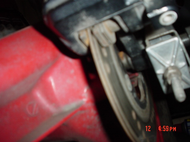

Hi, got a problem and hope somebody can help me out. I removed my rear wheel to install a new sprocket. I'm now putting the wheel back on and I'm having trouble understanding my clymer manual. There is a spacer on the axle on the right hand side. It has a skinny end and a fat end. Which end faces right? The pictures in my manual are a bit difficult to discern.
I'll include a picture to show which part I'm speaking of. Thanks for any help.

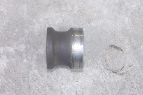

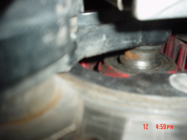

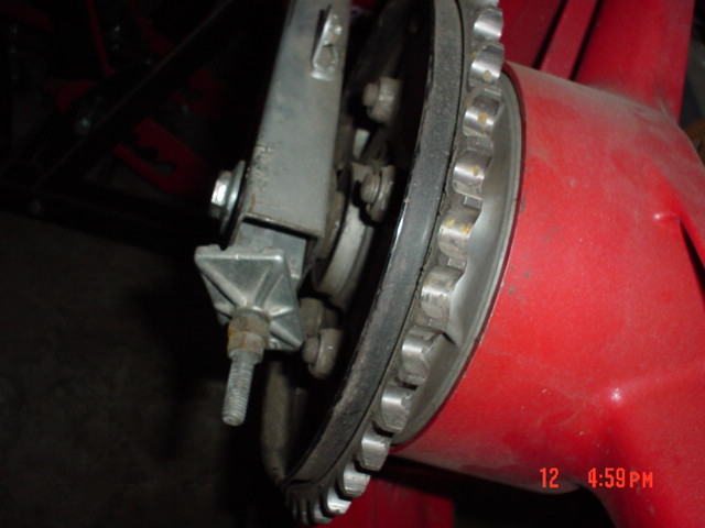

The "fat end" goes toward the bearing, skinny end toward the swingarm.
