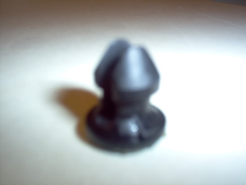

found out some of my tabs are missing, how do i replace those?

I replaced tabs on mine by cutting squares of sheet metal and using jb-weld to atttach them to the backside of the plastics. drill a hole in it for the mounting bolt and away I went. I will try and get pics later on to give you a better idea. worked all last summer and everything held up, even at 135

what tabs are broken on your fairings? if its the push in ball type tab, i think i found a good solution.
chasing an electrical gremlin on my 86 VW jetta, i pulled the horn cover off from the steering wheel. i noticed the cover attaches with a similar push type tab. it even has a nice base to glue to the plastics. so just go to the junkyard, look for 80's-early 90's VW's, and remove the tabs on the steering wheel horn button.

that does look like a good idea. I had used jb weld to fix a bolt to one of my rear fairings. I slide the bolt through where the push tab would ga and can reach behind to thread the nut on it. works great, been there a little overa year and still does its job
