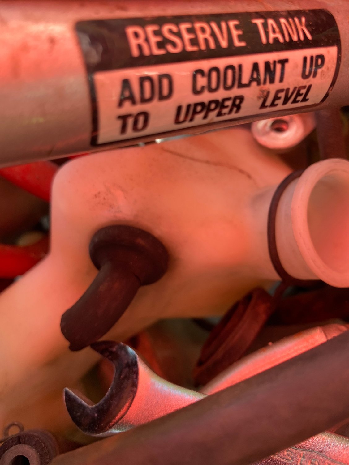

One of the hoses coming from mine is cracked and I am trying to figure out if it can be repaired or if it needs to be replaced.
Cracked hose coming from reserve tank
I pried at the rubber at the bottle end but it seems pretty tight and I didn’t want to go further.
so I tried to take the bottle out but I can’t figure out how to get it out short of removing the rear shock, as the bottle curves underneath it on one side, and in the other side the bottle is pressed against the frame.
Anyone done this ?

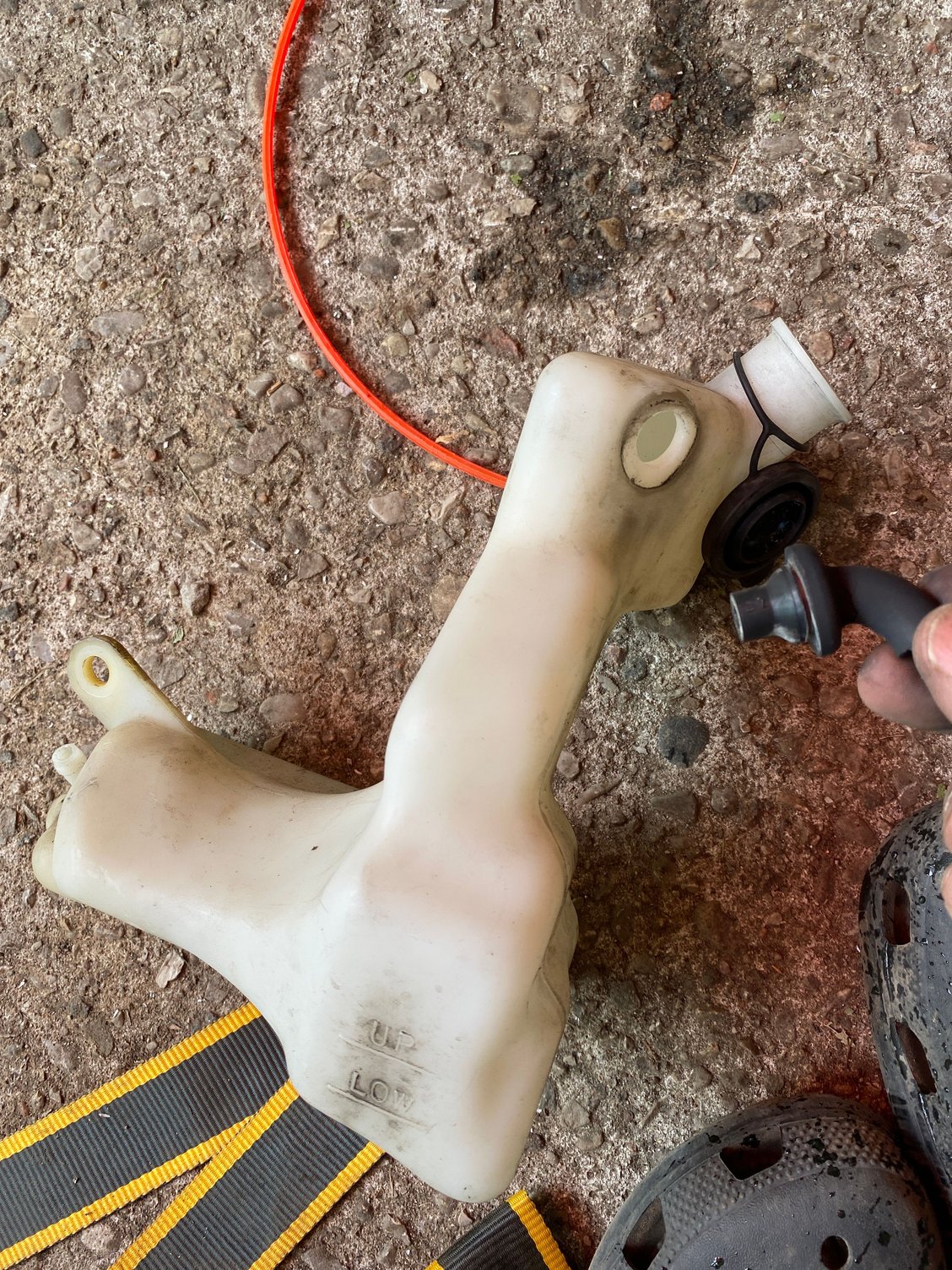

Whoever designed this thing made it clearly did not anticipate it needing replacement very often. Here’s a picture in case anyone is interested:
the bad news is that I was hoping there would be a plastic nipple at the bottle and that a fix would just be a matter of replacing the hose. But it turns out the grommet in the picture and the outgoing hose are on and the same piece.
I will see if the hose/grommet is a separate piece but even if it is I am guessing it will be impossible to order from the dealer and there would be little after market for this.
