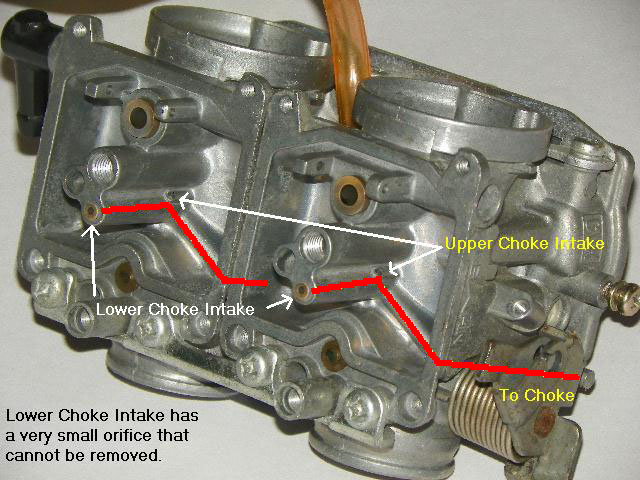

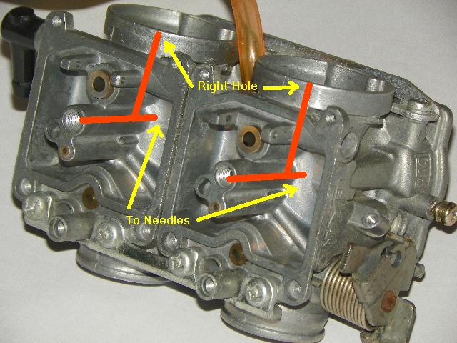

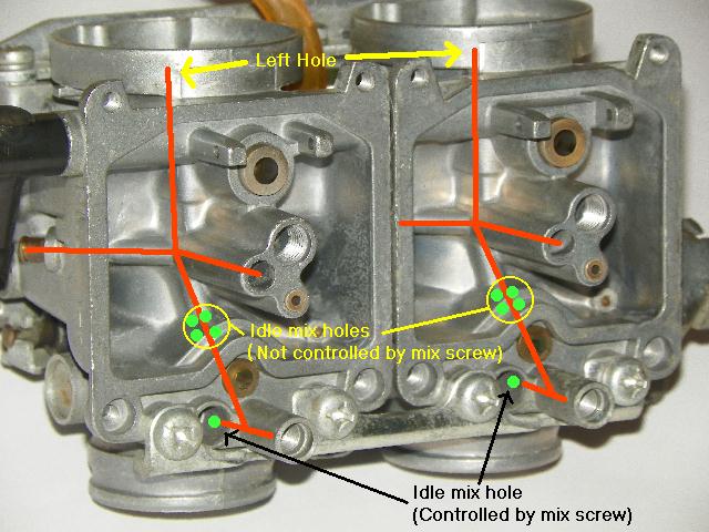

This is pretty common on old bikes. Clogs from petrol tank takes couple of rides to work their way to carbs, then clog it up.
Carbs are actually perfectly fine. It's cleaning out the clogs they need. Jets are metal and never wears out, so no need to replace them. Just clean and unclog them. If replacing anything, ONLY get brand-new factory OEM parts from authorised Honda dealer.
Problem is rebuild kits are aftermarket and parts don't actually conform to OEM standards. Jets sizes won't match and won't even match themselves within same kit.
Main issue is always secret hidden passages in carb-body. Lots more surface area for clogs to build than jets. And you can't see inside these passages, so easy to over look. Those 90-degree bends really love to harbour clogs. Best to use test-tube type brushes and PEA-based fuel-system cleaner. Definitely works way, way better than Seafoam, which has high percentage 30-40% isopropyl alcohol (ionic solvent). Which doesn't work very well on dried petrol plastic deposits. Need non-polar solvent to work on dried petrol plastic.

Update: I think I ran out of gas on the highway and that's why it quit. 😳 I had put in a gallon or so and am thinking that the combination of running it quite a bit before riding, then the riding, plus the fact that there was probably gas leaking through the overflow while riding. I pulled it out of the trailer yesterday and it didn't seem to have any gas so added a bit, then it fired up and ran (poorly). Still going to pull the carbs.
Thanks for the carb pics. I'll get some PEA cleaner and keep working on it.
