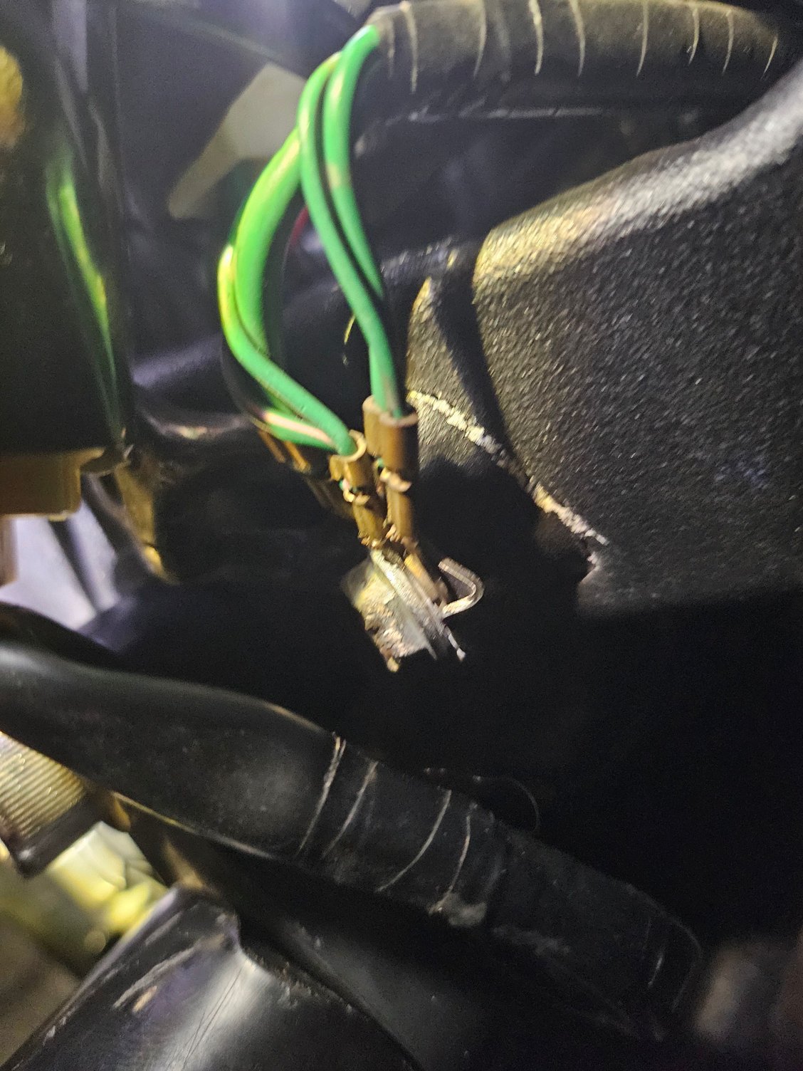

Is it possible the ground wire not in solid contact with the frame could cause this? Someone mentioned it. I checked and on first inspection the wires were tight making good contact. So I brushed it off. After hours still coming up with nothing I took a closer look and the piece that the wires are grounded on has been punched out! All the way through. I poked it in and the piece was completely loose(like a jenga piece). It must have happened when it was dropped at low speed a while back. The frame slider and fork spindle barely allowed plastic to touch. So that seems strange.
Was thinking using some jb weld?

Post photos of this damage.
Never ever use JB weld for anything! Well, maybe thin plastic that has lots of overlapping surface-area. If you want to join metal, especially anything that conducts electricity, real welding is only proper operation.
To test if it’s ground wire issue, make additional ground to test. Connect 1 jumper between batt-neg terminal and other end to big bare bolt on engine/frame. Then try starter.
This is 5-min fix with meter measurements…

Yeah, I've been waiting for a pal w a multimeter who "knows what he's doing" to come by. I'm wondering if it would be possible to weld that.
Let me see if I can get some decent pics.
