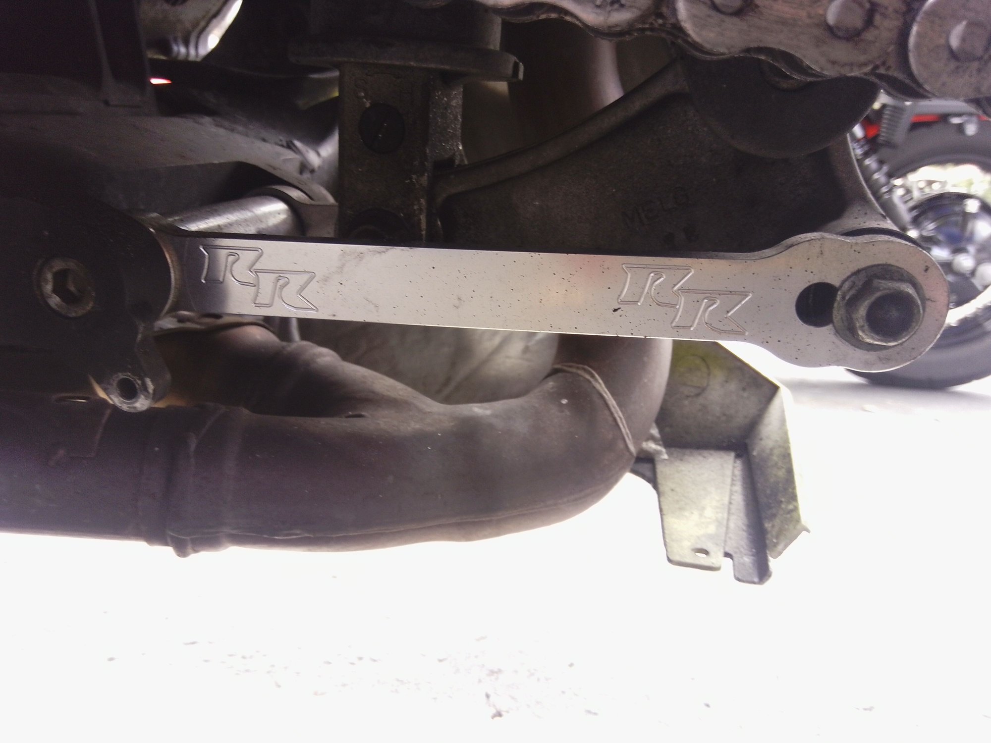

Hello everyone I recently bought a CBR 07 1000re but it's stretched and lowered in the front and rear .
Do I need to buy the original link again and replace that one ? Or can that one be used to raise it back ?
What about the front suspension. Is that just a unscrew and bring it back ?
What about the rear stretch do I need to buy an original axle nut , sprockets and chain ?
Thank you in advance.

Need original swing arm and linkages, new chain and sprockets. The front end should just slide back in the yokes.
