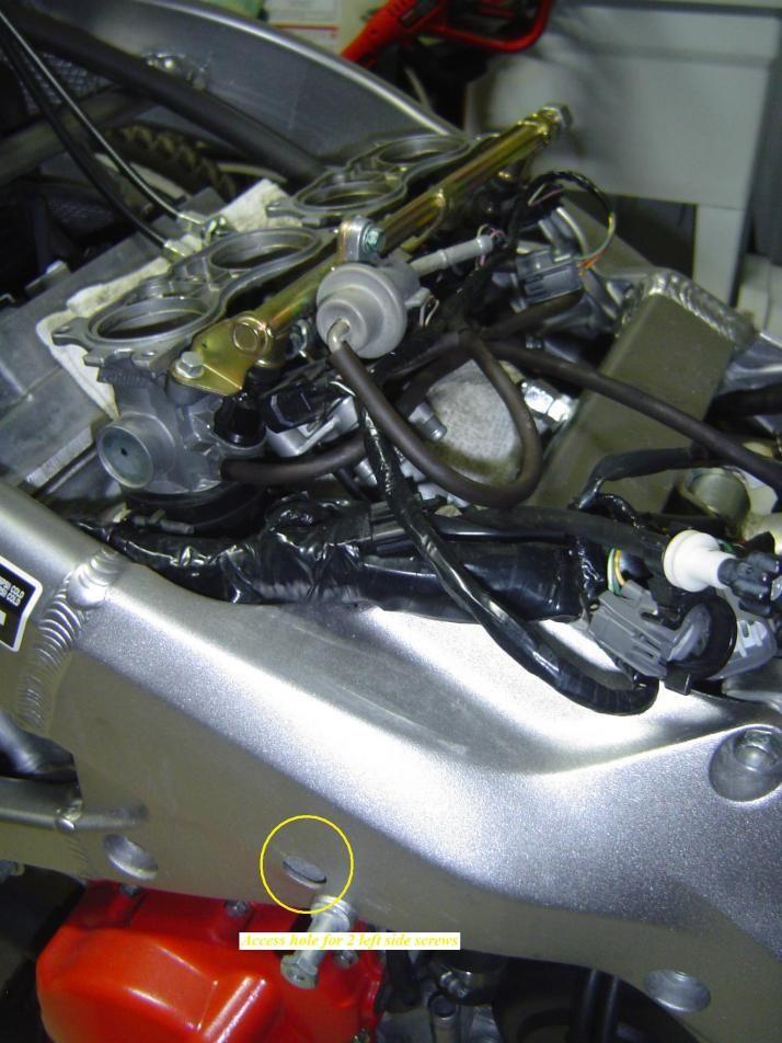

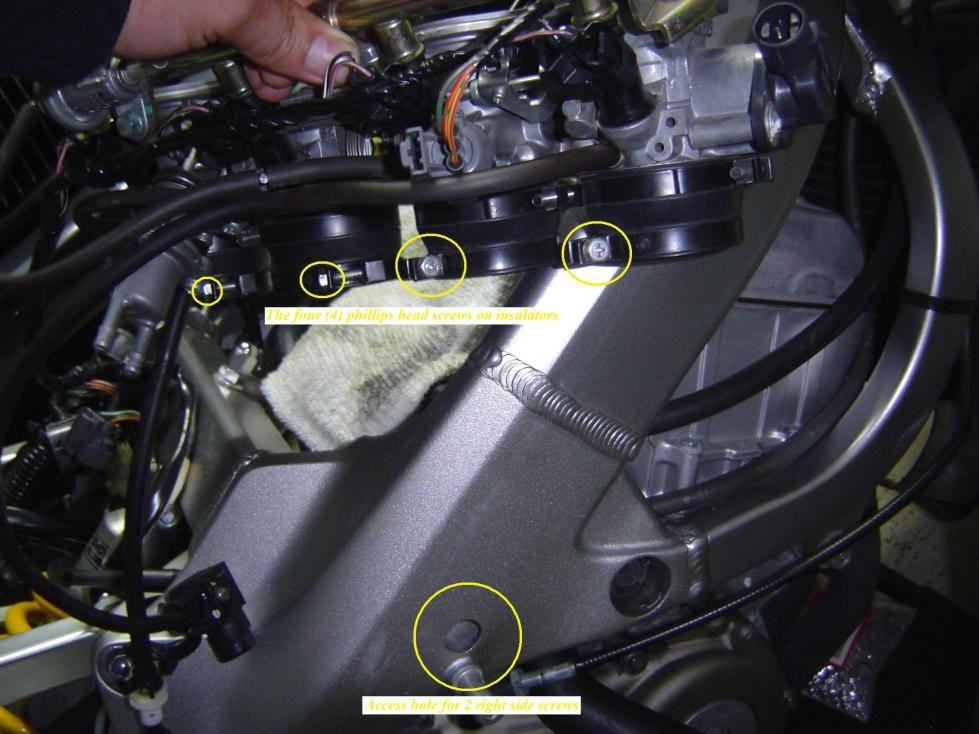

That's very strange. I found some pics that might help you did you use a long reach Phillips/cross head screwdriver to loosen the clamps?
If they have been removed before and over torqued the rubber can fuse to the TB, if you can prise the rubber and spray some WD40 in there it will help, also maybe the hair dryer isn't hot enough and you need a heat gun for a little more heat. please make sure you have some rags covering the TB ports, worse case you may need to buy a set of new rubbers.
ALSO, do not use the fuel injector rail to pull on the throttle bodies...bad idea.
Take your time and don't rust it.

Note the rubber tabs in the frame to reach into the clamp screws.
