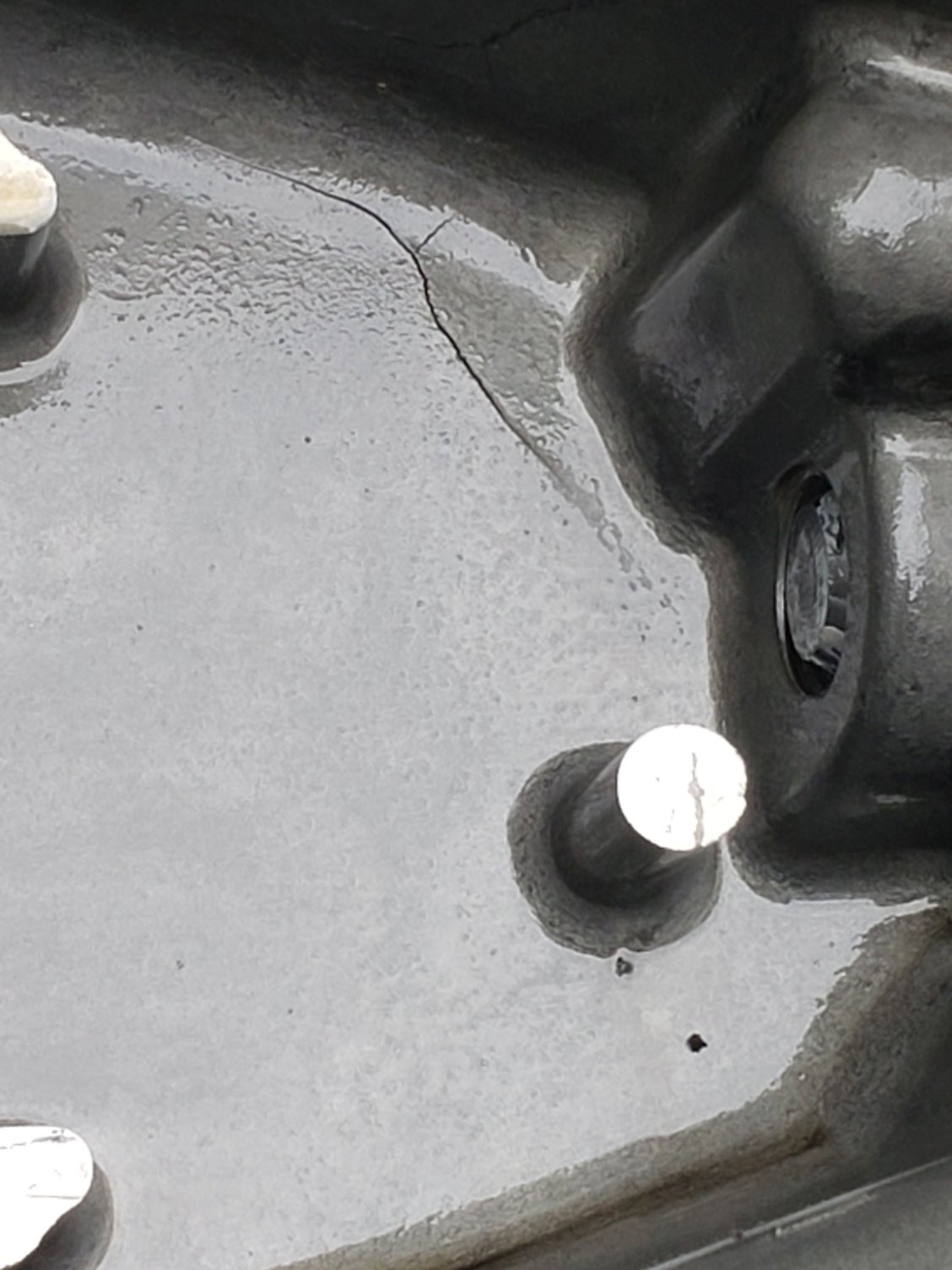

Hi guys I know I'm always coming to ya'll but I'm not mechanic when it comes to bikes. I finally got the bike back on the road and she is running good, except I did noticed a small oil leak when the bike is running there is no leak once I park it the leak starts is not constant but when I come back ( 2 to 3 hours later) there is a small amount of oil, I checked and the drain plug is tight and the oil filter is too. I'm hoping is a gasker seal somewhere I can replace ill try to get pics soon. thank you all.

after 4 hours after riding

Yes I took you guys advise, I cleaned everything I replaced the oil drain plug with a new one from Honda and a crush washer, I replace the old oil with NEW oil, and I noticed that it started to leak again so I took a closer look and the bike has a hairline crack in the bottom of the oil pan........ WTH!!!!!!!! so I took the bike to the local bike shop to see if they can fix it for me since I work ALOT.... and they quoted me at $657.45 to replace the oil pan, I said OH HELL NO, is easier if I take a vacation day off work, get paid and doit my self...... lol so I ordered a new oil pan and I will doit my self..... anything I need to know about how to doit?

Well I tackled it head on and to my suprise it went really well, here are pics of the old oil pan.
I spend a total of $38.00 for the used oil pan leak free guaranteed.(Ebay)
Honda gasket sealant $6.99
So not bad at all, compared to taking it to a shop, having someone else doit and paying $550.00 + tax for parts and labor
Thank you all for the support.
