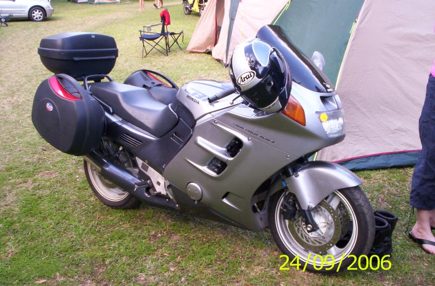

You may want to fit a set of "soft" bags to start with - they are much cheaper and if you don't intend to use them too often, they work well. Hard luggage is great (I have Nonfango luggage - 3 x 48 litre boxes) and you can carry a helluva lot of stuff. EXPENSIVE compared to soft luggage as they are mostly imported from Europe
Here's my 90 with "elephant extras"

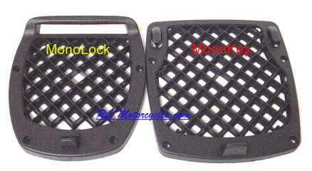

The MonoLock uses a catch system where the tang on the bag slips under the open slot in the top plate.
The MonoKey uses a catch system where the tangs on the top or side plates slip into the bag.
MonoKey bags will not attach to a MonoLock plate and MonoLock bags will not work with MonoKey plates.
Attached Thumbnails Would Like to get luggage for a 87'-monokey-monolock-mount.jpg

Thanks Timbuc, if those two plates are for the same size bag. To me the monolock seems it would be more securily attached to the bike
My MonoKey bags lock in tight. I have not tried to wiggle a MonoLock bag as of yet. I think the opposite of you as I don't know how a tang would lock in tight until I see one.
