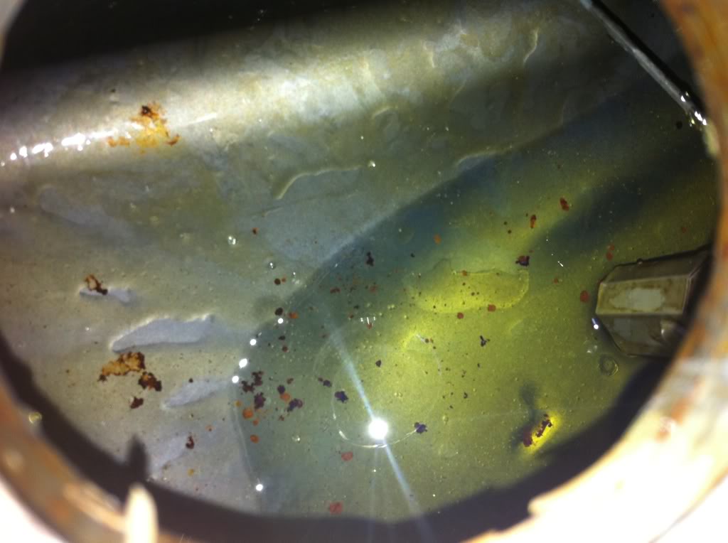

Ok, Ive been shoving wire up the small hole trying to break through.
I think the "PO" sealed the tank with something weird and now the air passage is plugged.
This is a look inside the tank. There is a little gas in there but, the yellow parts you see are kinda thick.

Buy a couple of quarts of kerosene, pour in and swish around and then drain out. that will clean your tank without blowing yourself up. let it air out to dry. Use an air-hose blower and a piece of tubing to get a good seal to blow the vent clear. DO NOT have the tank cap closed when you blow air into a tank (you will ballon it, if it's sealed). When you get the tube cleared, rinse the tank again with your (paint-strainer-ed) kerosene. and you'll (hopefully)be good to go.
