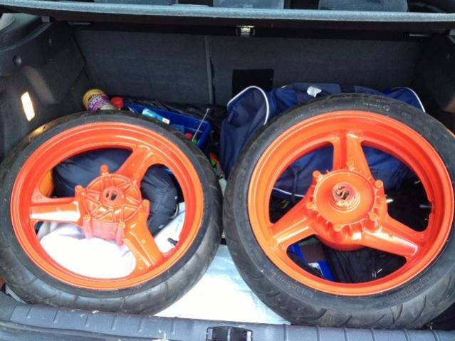

They sent me 42s, but the ones that came out were 47s, absolutely no idea what has happened to the rim, wether there is supposed to be an insert in the bearing housing but 42s are way to small.
Looks like I will have to order some RR bearings.
Can any one post a pic of the bearing in situ on a 90 on wards rim please
These are the rims I have
Thanks Alan.

Alan, I think Bordo is on the right track. No CBR1000F front rim has inserts or bearings other than the 42mm 6004s. I think you may have an CBR1000r or rr rim. Or even a CBR1100 Blackbird rim.
Is the centre hole (inner diameter) of the 47mm bearing the same as the 42mm bearing. If so, axle size is the same?
Cheers, SB

Well that's a mystery then mate. There aren't any inserts or sleeves in the rims either. The 6004UU bearing just slips straight into the rim with a circlip over the top. Your pics look like genuine 1000F rims but as to how it has 47 mm bearings in it I can't answer that one....lol.

Thanks for the input. Well I have spoken to the guy in the in the bike shop I got the bearings from, and he was a bit stumped, but he said he has come across this before once, but he is gonna sort out the ones I need plus seals and take the others back.
Next dilemma is wether the spacers are going to be right.
Thanks Alan.

Well got some 47mm bearing and fitted them on Saturday, went in fine put spacers in and fitted the wheel and all seems well on alignment, callipers are off at the mo but fingers crossed they will line up also.
