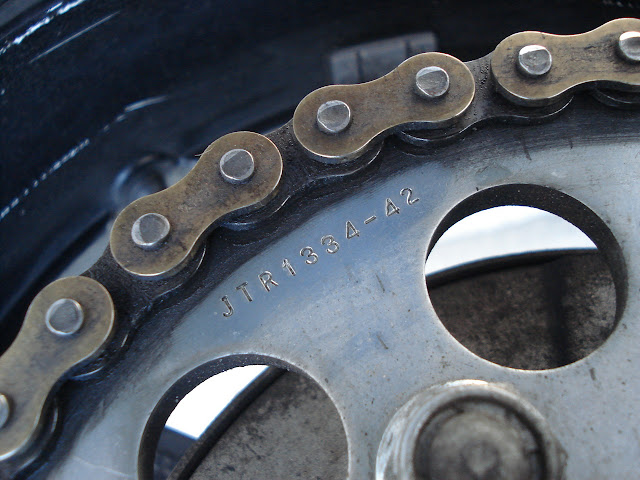

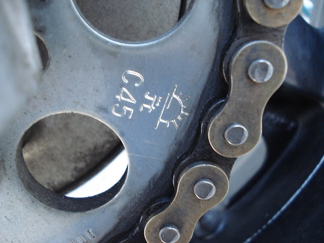

Nope, I'm not Luis and I correct myself, turns out I have a 17/42 combo, this was my mistake:
Thought that number meant the tooths on the sprocket, but no, is this one:
Counted them and yeah, 42 is correct. Did the same with the front sprocket, 17 tooth.
Tested it this weekend with a digital speedo (measures up to 299km/h), wich is pretty much the same as a GPS in accuracy, using the tire outer diameter (at 36 psi) to calculate speed.
These are the results:
- Below 100 km/h (63 mph) both speedos show the same speed.
- Above 100 km/h (63 mph) the digital shows 5 km/h (3 mph) less than the analog.
- My guess is that the error increases above 200 km/h (125 mph) to about 7 mph or so.
- Tested tachometer in low gear, goes to 10.000 RPM with full throttle easily, so no error there.
- At 5000 RPM in 6th gear:
Analog speedo shows 160 km/h (100 mph)
Digital speedo shows 155 km/h (97 mph)
- Tested with my Kawasaki riding along with a friend of mine, both speedos showed the same speed at 120 km/h (75 mph) where the CBR shows 3600 RPM, and the GPZ 5500 RPM
I know measurements aren't 100% accurate, but I'm surprised that my bike is the only one doing 100mph at 5000 RPM, without any mods.
