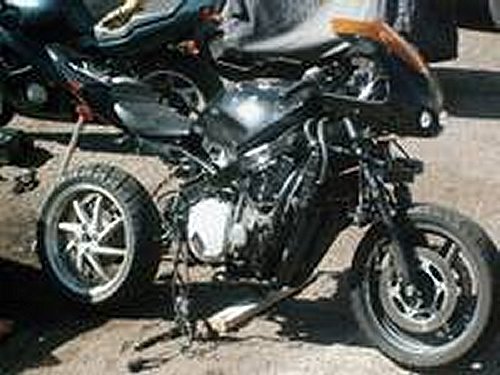

Heres a pic of my project mocked up ANY QUESTIONS LOL
http://w4.bikepics.com/pics/2009/03/...592764-200.jpg
need a lil help posting pics lol

here you go

Looks like single sided swing arm, F4 tailpiece, Hurricane tank, front end, frame and motor, UFO style front fairing.....................
Be interesting when finished........................

Front fairing is by Buell xbr1200 ligthning

Rear wheel looks like its a VFR

oo it looks like a gsxr tail piece, defo vfr back end, the rest im buggered if i know lol. hmm like the idea off a vfr rear end cool.

ok guys here goes started life as an 87 cbr1000 i added the vfr swinger last spring off of a 93... this sprind i decided to cut off the frame and ad a rear tail from an 05 1000rr when finished will have undertail exahust.... and the front fairing and lights are buell xb i did all the fab work myself and i should have everything finished upby mid april and back on the road... kinda took parts off all my favorite bikes and put it all on one... what do you think

Needs a new home for the oil cooler, maybe something like the Buell setp (off to the side)

when its all finished up the oil cooler will mount to the origional part of the hurricane speedo bracket up inside the buell fairing and hangs just above the front lip by bout an inch and sits about an inch and a half below the bottom lip its just kinda hanging out in the pic
