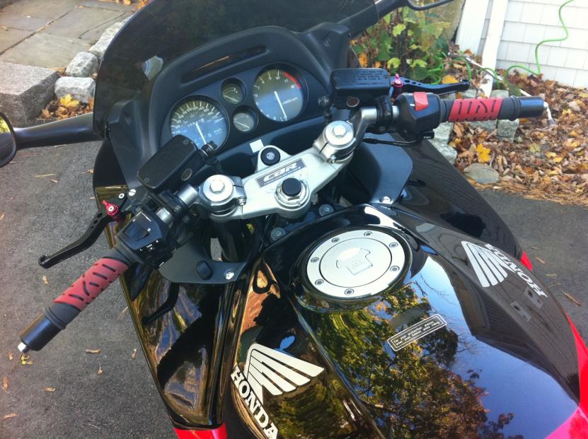

Also Karlo I have mine pushed "up" forward a bit more than yours -- straighter---
See where the pinch points are ...... gives a bit more cable slack ...also makes
steering input a bit more "precise" and besides you seldom go lock to lock on these
bikes
