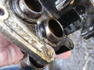

I recently found to my horror that a dust seal had popped out of place after my brakes seized up one morning a couple of weeks ago. It turned out to be a problem on one calliper (front R/H) and on closer inspection I found that the metal around the seal had simply disintegrated. The seal was therefore free to just come right out as the piston traveled to compensate for pad wear.
Here's a pic of the seal. It obviously seems in a hurry to go somewhere else, probably some fancy dress party or a mason meeting.

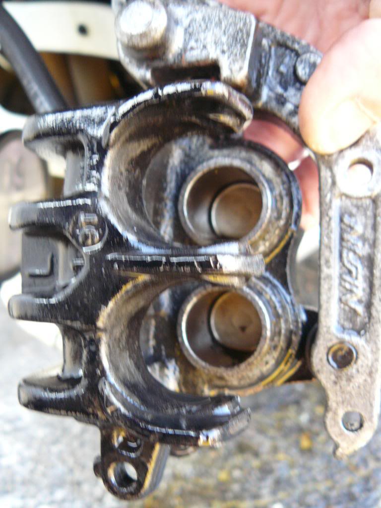

It didn't occur to me exactly what was happening when I first removed the calliper until I'd removed the pistons and seals and given it a good clean up.
Here's what it looked like after the clean up.

So, I changed the piston seals on both callipers, and after a good clean up and bleed they work fine again, better than they ever did in fact.

Have had the issue myself have not stripped them down yet. Good info & PICS Henry

Keep in mind that seals pretty rarely need to be replaced. A good disassembly and thorough cleaning will generally do the trick. It's important to note that the only thing that retracts the pistons when you let off the brake are the tiny ridges on the seals. IT's not hard to see how some dirt can inhibit that.
