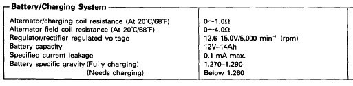

You say "Battery was charged initially and tested curcuit for leakage- less than 1.2 amp so all well there."
Somthing very wrong here ... Current leakage is 0.1 mA max.
See Workshop Manual page 1-12.
extract below..
Take your time - go through the voltages / currents / resistances as listed ... dont jump to any conclussions.
