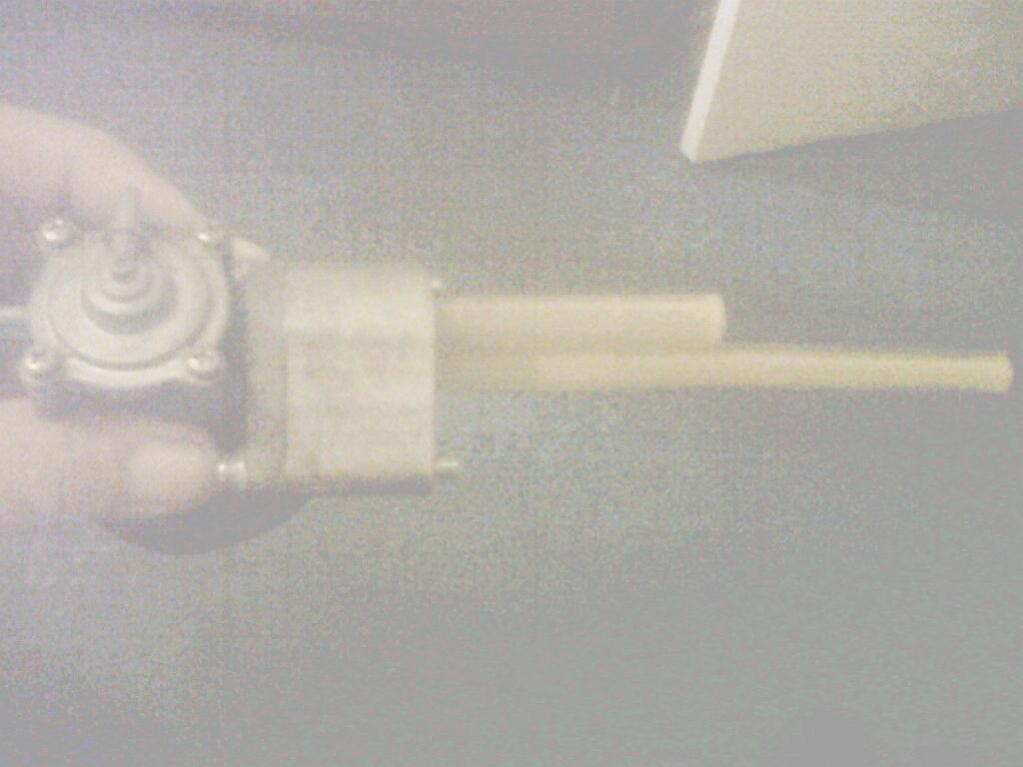

It sounds to me like there's a blockage there and it's not related to the vacuum - possibly in the tank. This is what your fuel tap looks like inside. It's not really clear in the pics but both main and reserve have filters which are covered with a fine (very) filter and have an internal filter as well, so any clogging of these will cause your fuel flow to stop.

Thanks to all for the advice. I stripped down the petcock valve last night on the kitchen table (wife was well happy!!). The diaphragm and rubber valve seat are connected by a stainless steel tube (all 3 connected as a single part). I went behind the diaphragm and pulled on the (what I now know to be) the seat rubber. It made a popping sound and I thought i has damaged it. In fact the rubber had actually bound itself to the seat (bike has been idle for 8 years). Tested it on the table by sucking on the tube, worked perfect (in both reserve and ON positions)
