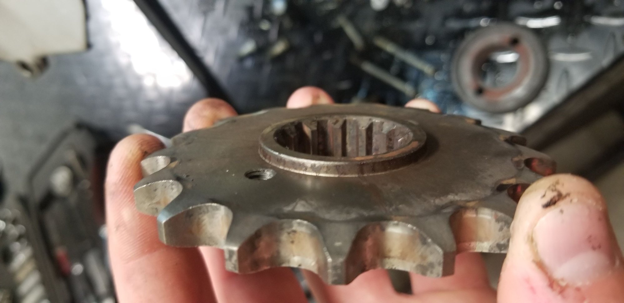

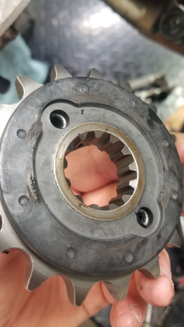

Now, the problem is that when I install the damper ring, it's still all loose (as if it's not doing anything. ) the damper ring is loose under the guide ring (plastic thing). I'm assembling according to the microfiche.
I'm assuming the damper ring is warn out. Where can I get something to replace it if that's the case? (There is only one for sale on ebay from Japan and its $16 plus $30 shipping) are there alternatives? Do you think this is the problem?

I had a possibly-related issue, where I needed an extra washer in between the sprocket and the frame for it to tighten properly. I was getting an odd noise from the sprocket, and my mechanic put this washer in to fix it. He inspected to see if the frame was bent, but was unable to find any issues.
Recently, I did chain and sprockets. My damper ring was also badly worn, which was leading to increased vibrations at the bars. I replaced the sprocket and the damper ring with this:

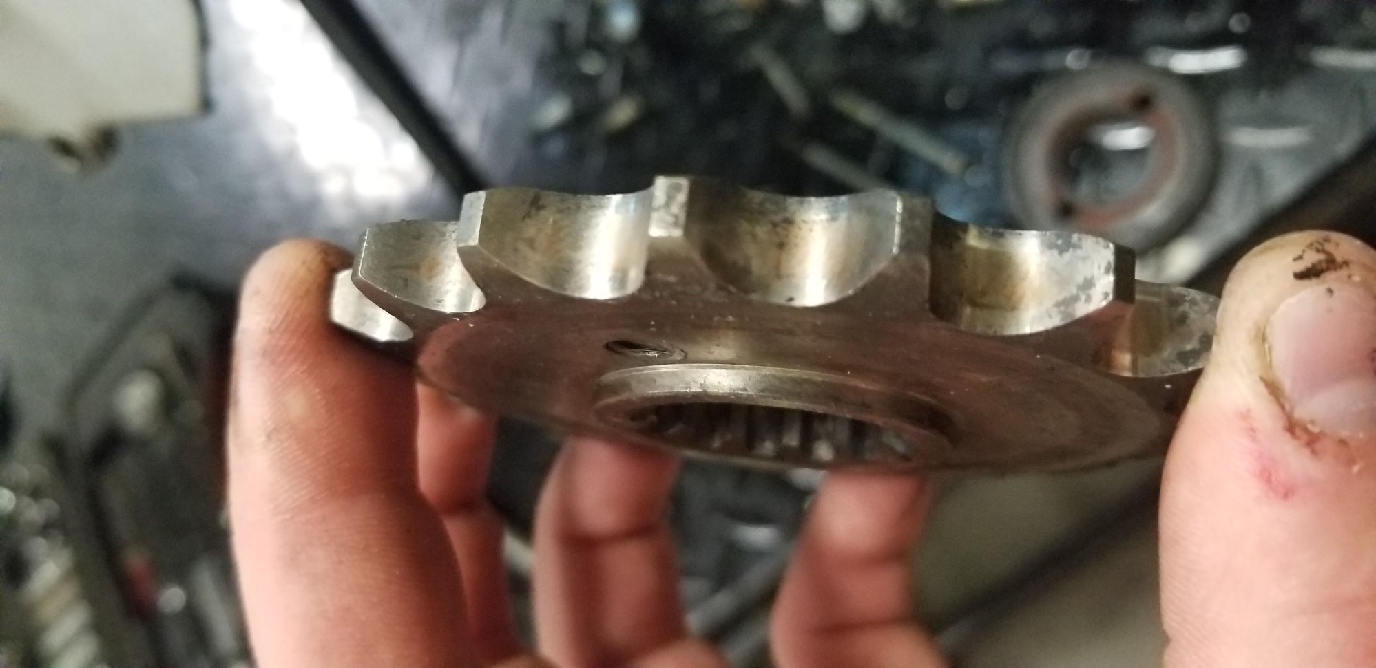

Nope, No play in the shaft.. is this amount of play in the sprocket normal? (SEE VID)
Maybe I've got the wrong sprocket?

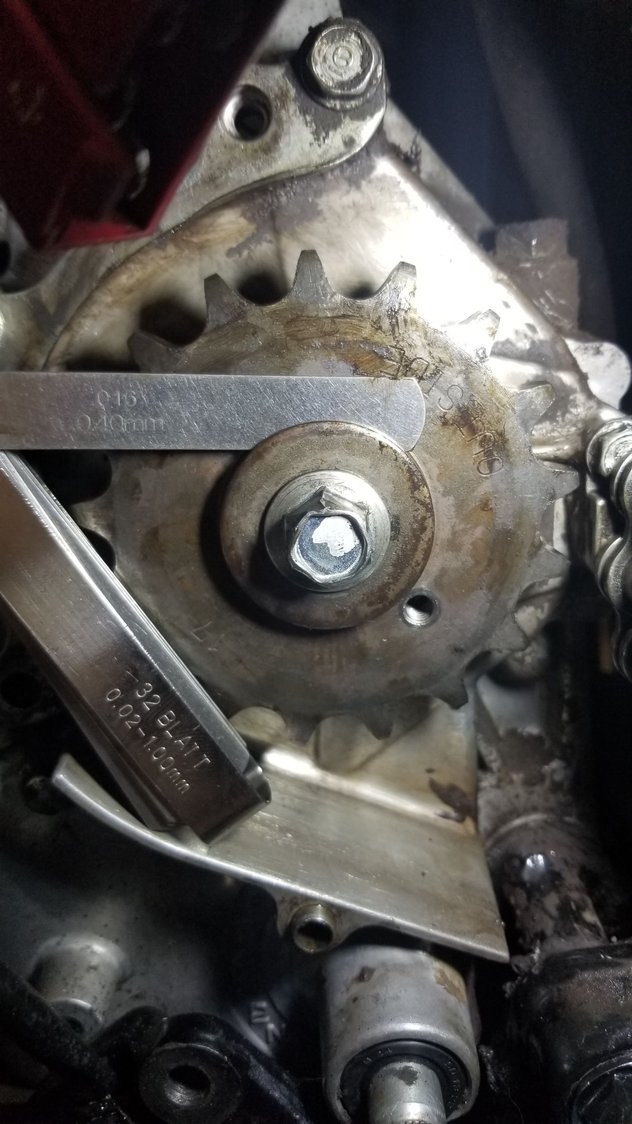

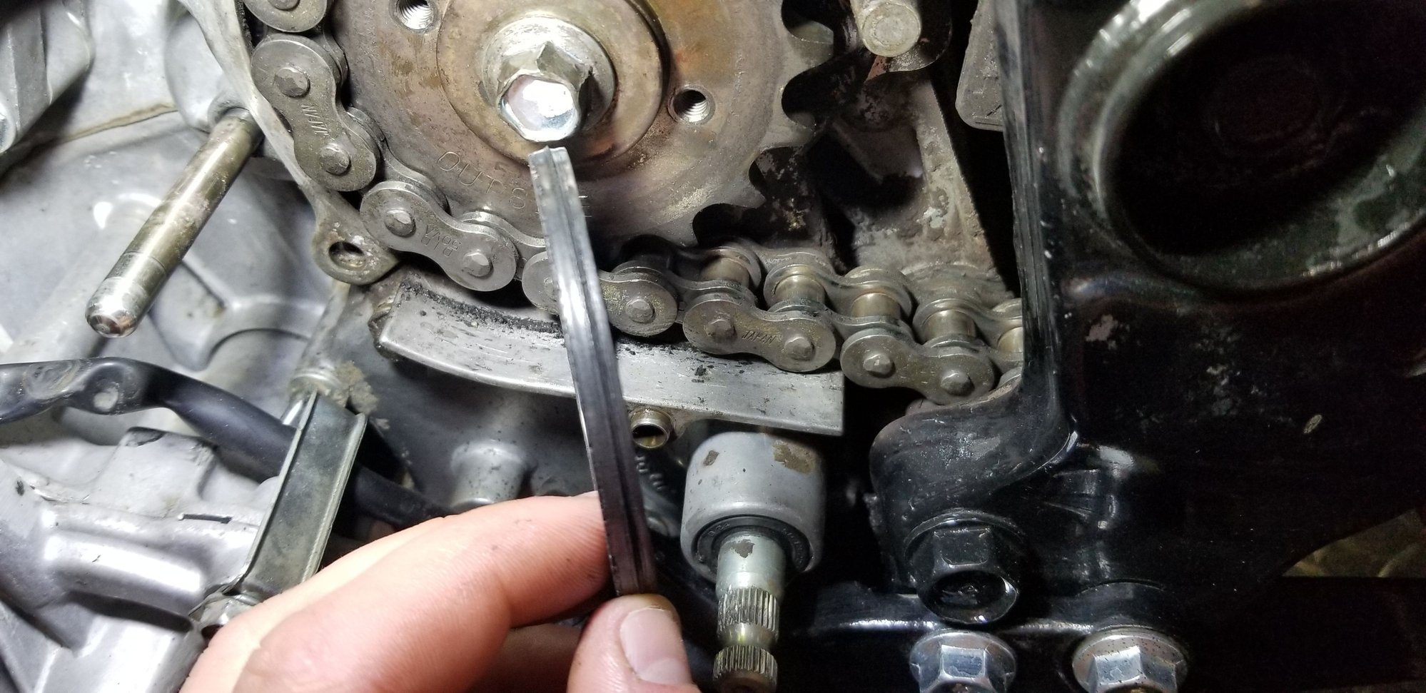

Well! Again there is no play in the output shaft when I pull and push on it, so he bearing feels tight... I dont know why there seems to be excess play in the shaft where the sprocket sits.
I can get a 0.40mm finger gauge in between the tightened washer/nut and the sprocket. Is that normal?
