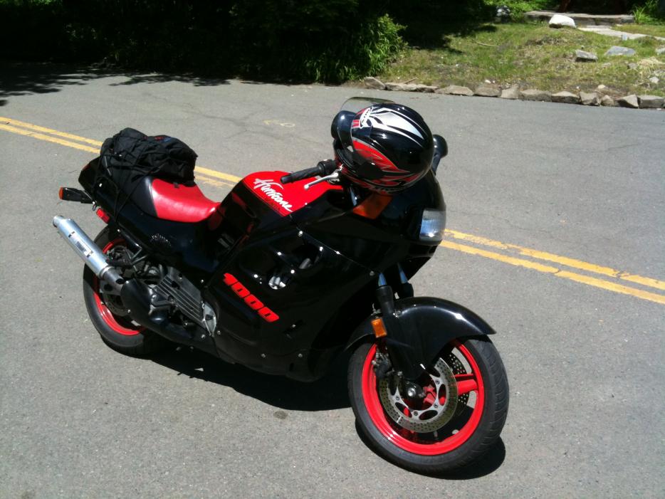

its just slipons, pics of them on his bike
