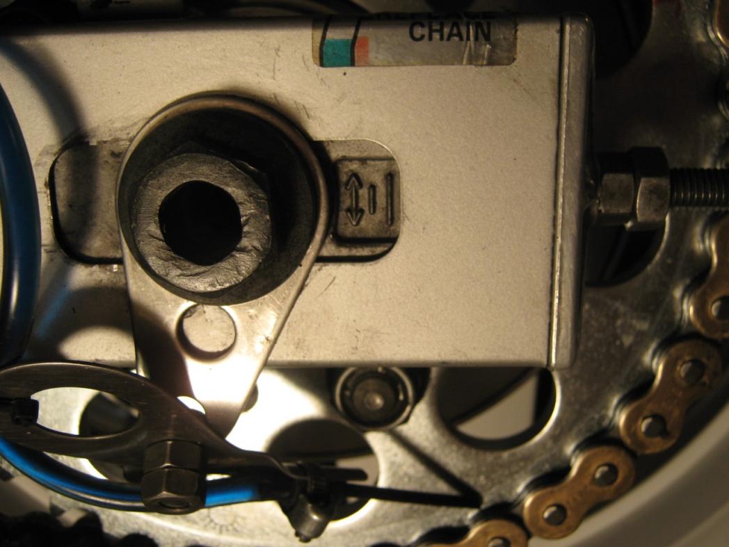

I have just replaced chain & sprockets on my '91 with the standard 17 front / 42 Rear sprockets + 114 link chain (DID50VX).
My problem is, the adjuster arrow is pointing at the far end of the green chain wear label... refer attached photo. I would've thought the arrow should point at the 'NEW' end of the green part ?
I have a suspision the chain wear label may have come off in the past & the previous owner stuck it back to far left ?
Can someone please take a piccie of their chain wear label so i can compare with mine.
any help appreciated....
fwiw, the old chain was well & truly in the read area + the drive sprocket was poked but still... i might've been able to get a few more 0000 k's outta the old one.

Don't worry about it mate.
The chain wear label is just a guide when the bike is new, and should only be used as the roughest of guides once the original chain and sprockets have been replaced.
As long as your chain is correctly tensioned and lubed you're good to go about 2.5-3.5cm of travel in the centre between the sprockets.

yep +1 ............. I'm missing both my "guides" lol ....... really they don't mean jack !
Keep my chain slack at between 1/2 to 3/4 inches
ooooouuuu them is some nice shiney sprockets tho ' !!! lol

But anyway, Mr. Chips....yeah, the stickers don't really mean much. I do use the center indicators, though, for alignment, and they seem to work well. Since I have a larger rear sprocket, it pulls the wheel forward anyway so my indicators would be useless to show replacement. It would never reach the "replace" mark.

The stickers are put there to guide you but shouldn't be a real yardstick IMO.
Up to 1" of slack, but turn the wheel slowly and feel for any tight spots in the chain and don't over tension.
