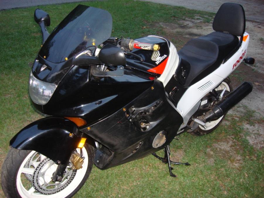

90-00 all the same for seats. I have used the same Corbin seat on a 91. 94 and 99 models.
Dub
Attached Thumbnails Backrest (sissybar?) for a 'Cane ??-88-cbr-update.jpg   Backrest (sissybar?) for a 'Cane ??-88-cbr-trip-mode.jpg
