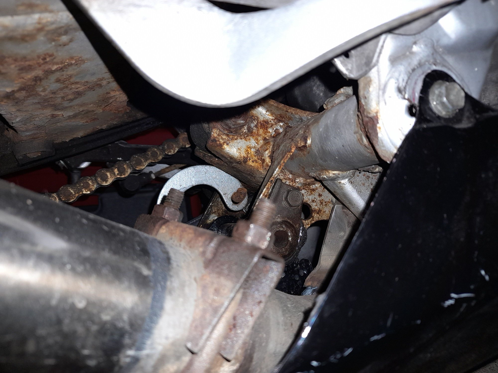

I am still having a bit of trouble with installing the center stand. Where does the spring attach to the bike? If anyone has a photo of how it goes, please share.

Whilst the pivot is different the spring arrangement appears to be very similar to my CBR600F2 where the other end of the spring attaches to a hook on the bottom of the frame.
