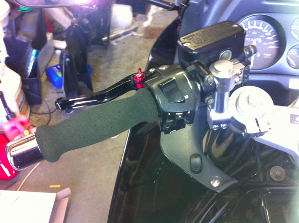

but do take the dropped angle out of it a bit - been there done that and........... changed it.!
DanMoto 3D bars in 41mm silver or black will give you the max amount of options
height, angle & sweep for about 69 USD ='s maybe 5 quid sterling lol
seriously though - they are what you are after imo
Link
If ya go that route let me know - I'll help ya with fitting them ( hacksaw & drill )
& some longer hardware (nuts and bolts) for safety and insurance sake
Pic of them fitted to my 1993 CBR 1000F

They look pretty straight forward, are they easy to fit, (you mention drills and hacksaws), the price is good, $69, the shipping cost will probably be the same to the UK. Is there anything I need to know before I go ahead and order?
Cheers, Steve
