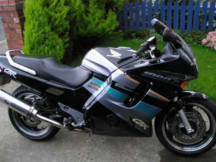

Hmmmm .... I'm truly baffled now, Sprock .... the previous pic of the sump was the old sump that was removed from his bike ....
This is his bike .... Nice bike, owned for a number of years and seems pretty original????
The plot thickens. I don't have an explanation. Wish I did

Not sure if we'll get to the bottom of this, Woof .... but at least everyone's now back on the road
